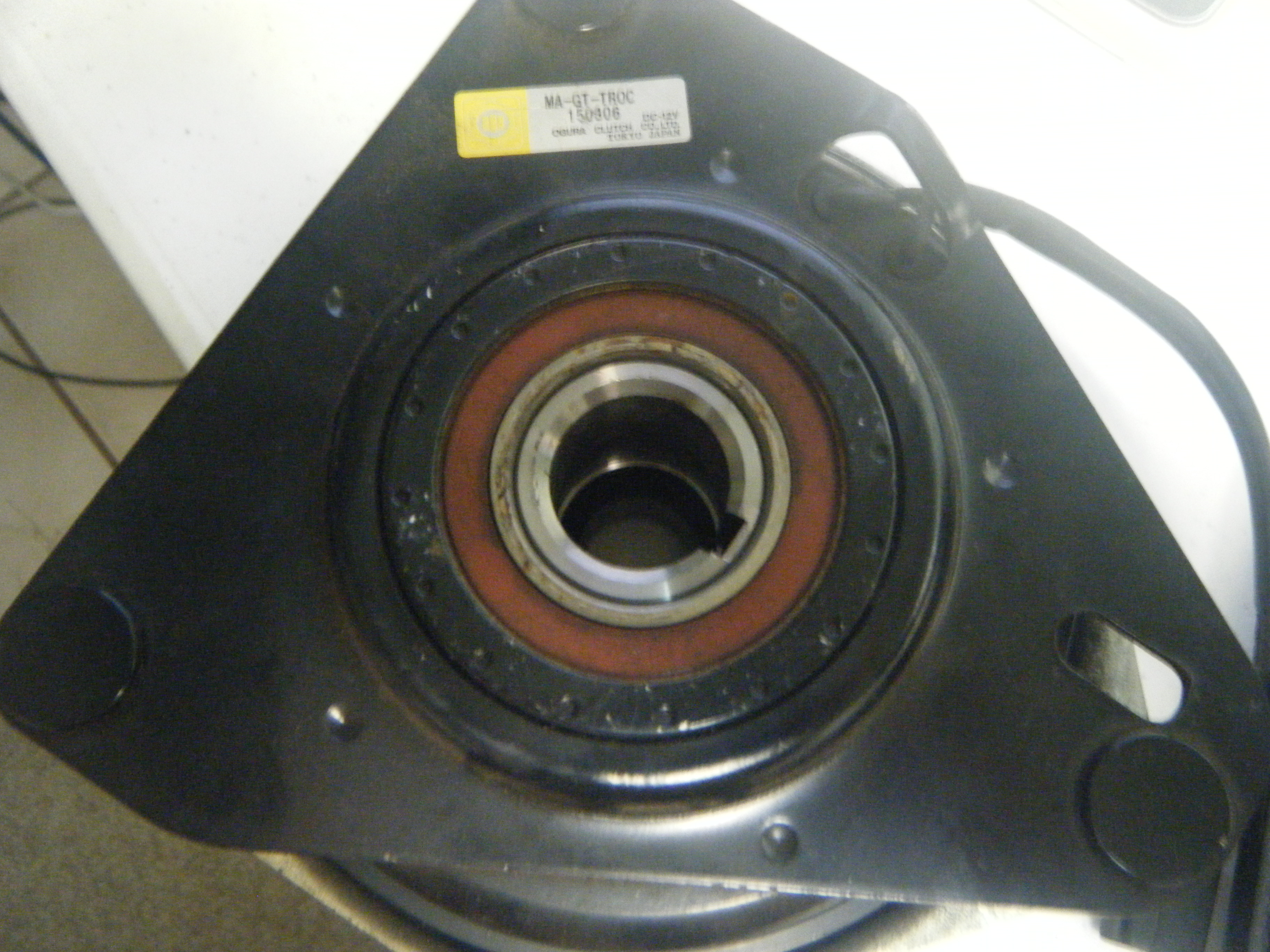

The one I took off is a OGURA M-GT-TROC trying to find another one at a good price????????????
Who has them???????? Toro part# is 54-0220.
Pictures of the one I just took off.

I tried the Fatboy Extreme and the pulley was to thick or wide so I could not get it behind the frame of the 120 to get it on the shaft. I haven't tried the
Stens. One clutch a company sent me had the square key in the center instead of having the notch which I need. Had to send it back.
I need one with the notch so it can slide over the square key already on the shaft like the one in my picture with the shaft.

I tried a Fatboy one time and it won't fit between the frame and the shaft when you try to get it install it. The thicker pulley makes it to wide to get
in to position. This model of Ogura is the only one that seems to fit. MA-GT-TROC

the square key on the engine shaft can be removed..
