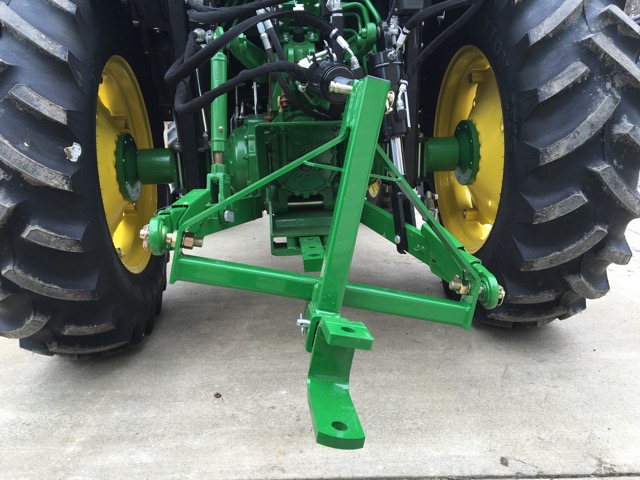

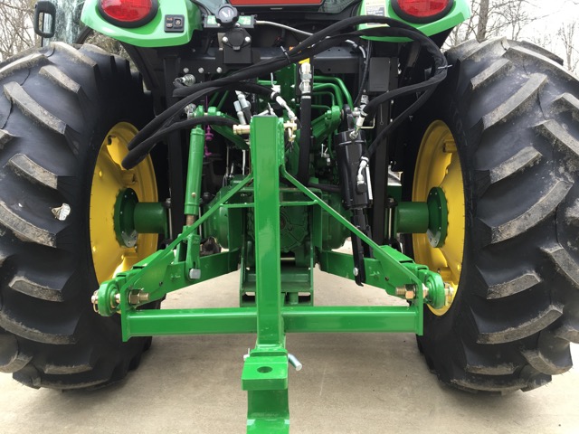

I'm not saying that 2 are no good. Just that if you have a set that is set up properly, or at least what I consider set up properly, there are VERY few instances where 2 hydraulic side links serve any "real" purpose.
I have done a lot of grading, and not just on flat ground and the need to have 2 adjustable side links has NEVER presented itself. Now I have read and seen many units set up on others tractors and people have complained about one thing or another. When I see their set up, I see why they have occasional problems. Either the units were built wrong, or they were built with a different functionality in mind and that in itself presents many other problems.
The pictures are of a JD factory "T&T" set up. Great setup if you want to tilt to the right only and you don't care about the slot float feature in the lower clevis being the same as on the manual adjust link. No big deal,:rolleyes: they still work.
No one has shown or even described to me where the 2 hydraulic side links accomplish anything more than a properly built single hydraulic side link will accomplish.
The only "real" benefit that I see is that you don't have to pay attention when you want to have the implement level-square with the tractor, just be sure that both side links are fully retracted. :cool2:
Enough of this, pretty sure that this has been dragged on long enough, it has in my mind anyway. ;)
