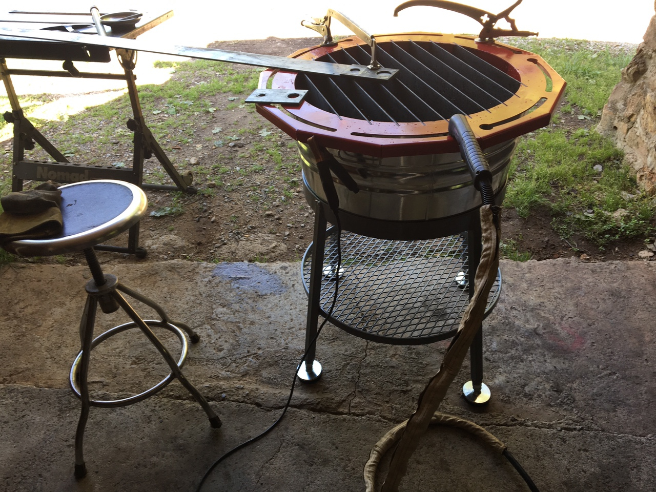

Use 911 Motorsports stencils and tub cutting table. View attachment 752801
That's an interesting welding table!
