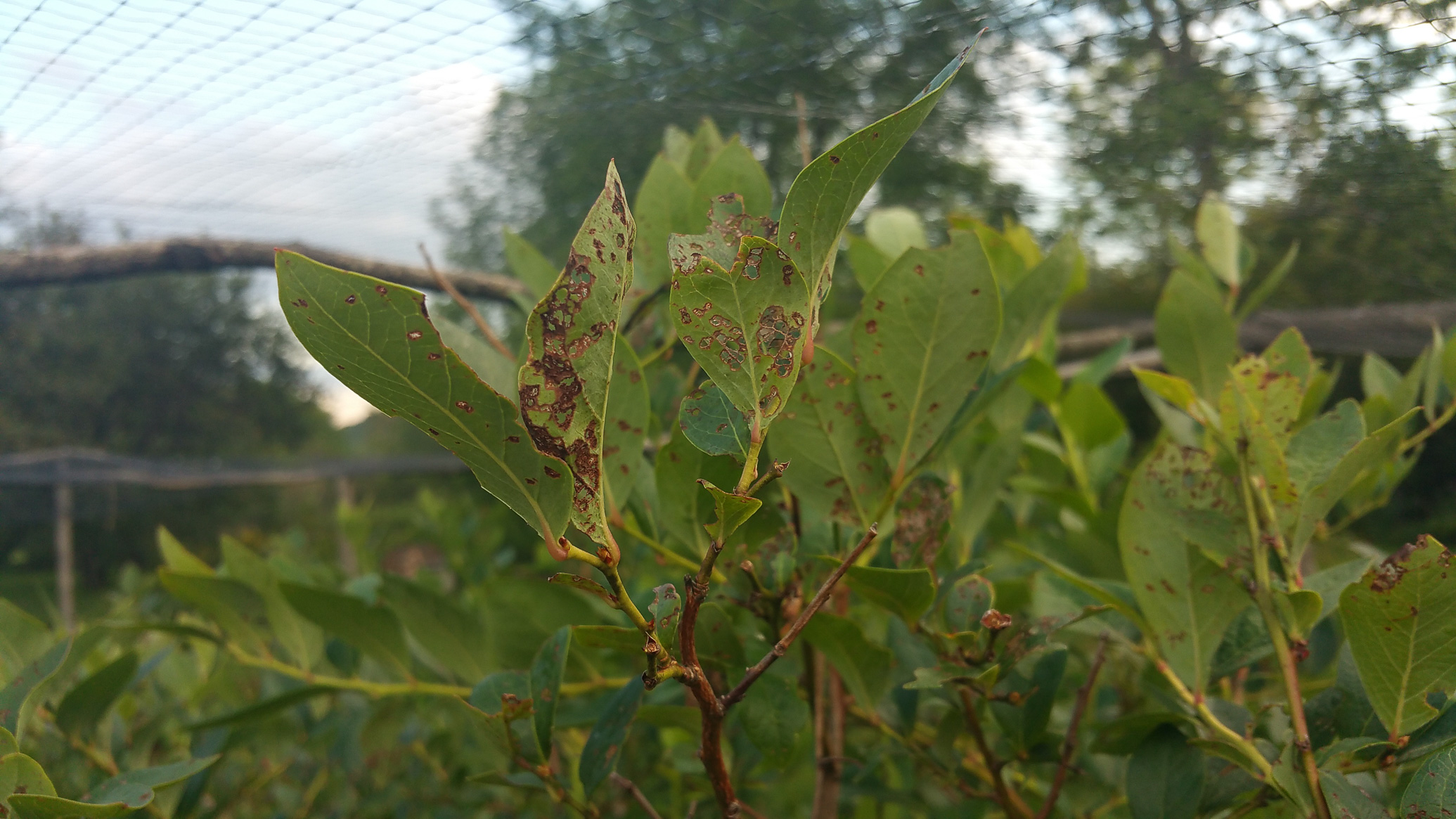

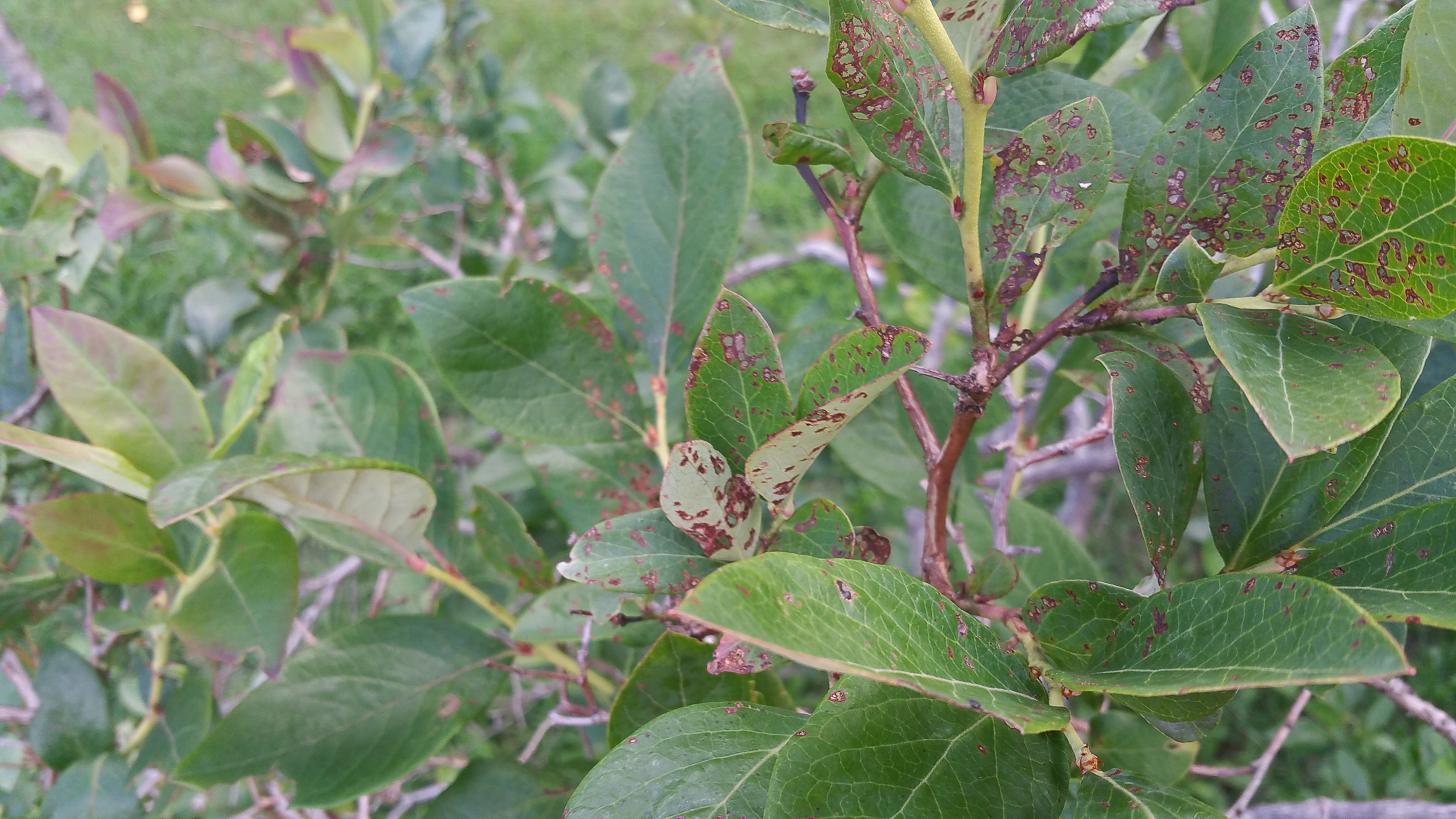

Typically get gallons of berries from 4 main and 4 smaller plants but last year less than half that.

The pics were taken late August of last year. Trying to figure out what the problem was and if there's anything I can do about it this season.
Birds are the biggest threat to the berries critter-wise but we have netting covering all of the bushes. In fact all of the garden is unfenced but for some reason, even though there's plenty of deer around, they don't bother it. No shortage of bears either but if they can't find some garbage left out or bird seed they just move on.

Well, a close look at the pictures shows me that this is not a problem related to furry critters. I'm guessing its either bugs or a fungus. Have you looked at the leaves with a magnifying glass? If there are spots that are moving its bugs, spots not moving are a fungus. Sevin will kill most bugs, Daconil most fungi. Don't know if Sevin is ok for food. Daconil is used on all sorts of fruits and veggies -- slightly disturbing once you see it [it has a slick, silvery appearance like something out of an evil lab]. But without it there would be no broccoli, celery, pumpkins, etc. I suspect there are organic alternatives but I can't name them. I'm sure there is someone on this site who knows -- this place never disappoints.
Your best bet is to visit your local Cooperative Extension Service office. The folks there will be familiar with plant problems in your area and they may be able to identify your particular problem from your photos. They will also advise you as to an appropriate remedy.

My guess....Japanese Beatles.

It might be called Septoria leaf spot disease. Just a guess from googling "blueberry diseases".
