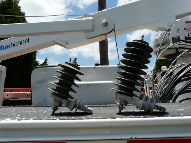

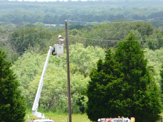

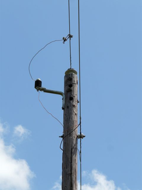

Follow-up.
The electric co-op installed a lightning arrestor on my line three poles from the house to stop any surges from as far as five miles away. See pics below. The lighting arrestor is the thing sticking out on the left of the pole and is attached to a grounding rod.

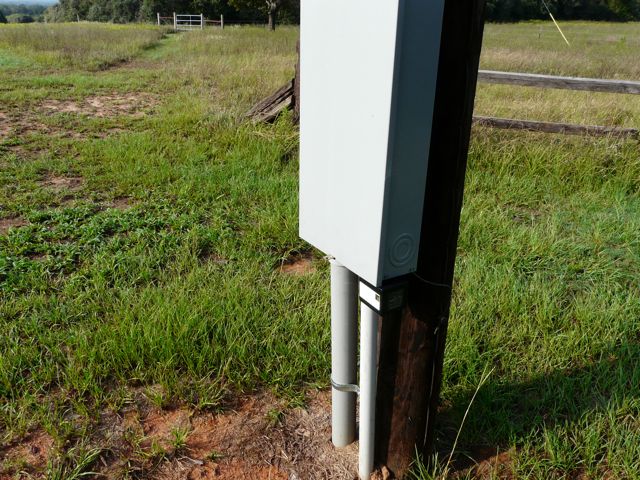

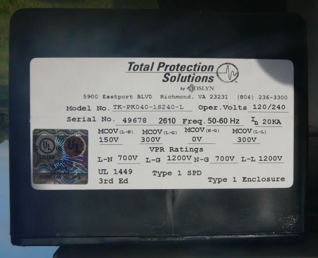

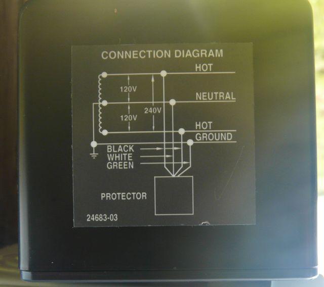

#32
My electrician installed the whole house protector on the breaker box on the pole see pics below. The whole house surge protector was from a co. that the elec. co-op recommended. I also added individual surge protectors on the 110 outlets inside the house. I'm ready for a storm, let it rain.
