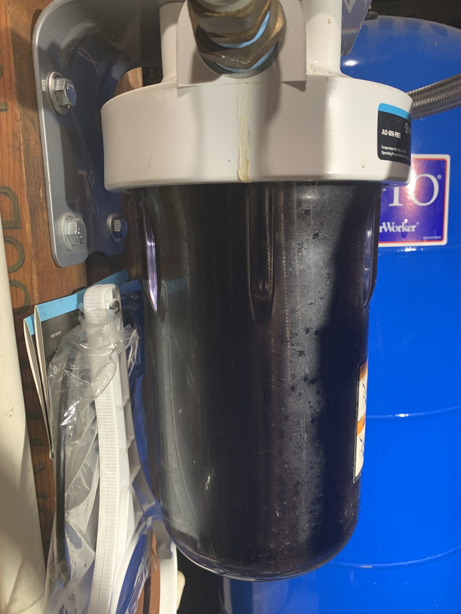

When I drilled the 580' well for the new house 40 years ago, the well driller said the water was good. It looked clear and tasted fine, so I didn't install a treatment system or whole house filter. When I had the submersible pump replaced 10 years ago, it was coated with a black slime. The well guys said it was just harmless black sediment. At that point, we had been drinking the water for 30 years with no health problems, so I guess they were right.
As a precaution, I installed an A.O. Smith whole house filter:
It uses a variety of filter cartridges for different contaminates but I used one for simple sediment:
Out of the box, a new filter looks like this:
After a week, it looks like this:
The water looked and tasted the same before and after installing the filter but what it catches is amazing!
Black slime is usually (harmless) iron oxide bacteria
We get a little bit in the toilet tank but I've never seen it in my filters. I'd be really surprised if it's in your well; IMO send a water sample (taken before the filter) to a lab and get it checked out ASAP.
