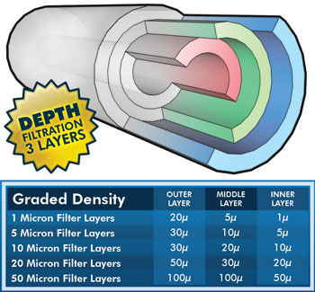

I am now using 10"x2.5" 20 or 30 micron pleated filters (i was using a polypropylene graduated filter (see pic below) that went from 30, 20, and ended up as a 10 micron). All the filters are clogging in about 2 or 3 days (depending on usage).. the mud is a fine paste that coats the filter. After it dries it just drops off the pleated filters though.
ideally I think a 20" 30/40/50 micron fleated filter would be an ideal first filter, followed up by a 5 or 10 micron second filter.. BUT I dont think I have enough room to mount two separate filters, but possibly room to mount a single dual filter..
What is 'weave' type'?
How wide is your 20" filter? I have seen them in 2.5" and 4.5"? I was also wondering if the 2.5"x20" housings would fit my 10"x2.5" mount? Do any of the filter housings have 'standard' threads?
brian
brian
weave type = spun polypropylene It's like a tight wrapped thread in the shape of a cylinder 2.5"
Dunno about the mounts.
