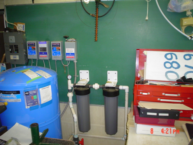

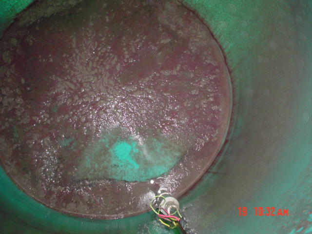

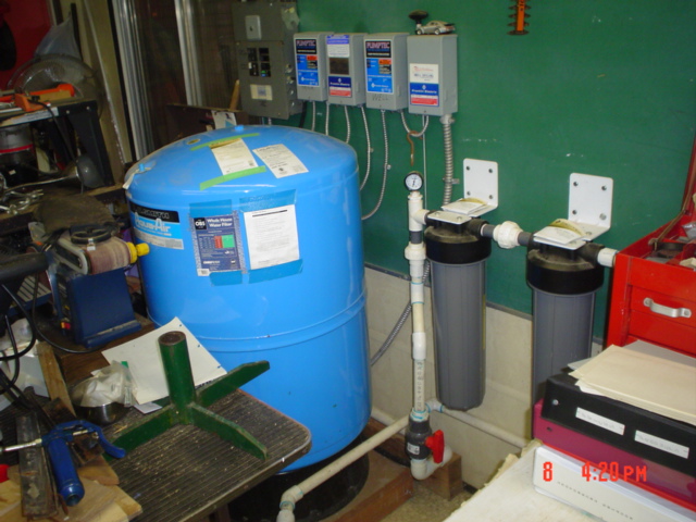

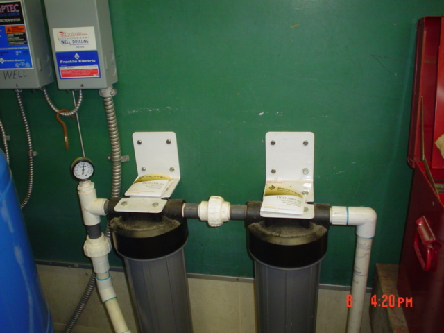

czechsonofagun - Here are some pics of the two filters we used to use for our water. The filters start out white and then get grey as they start to get covered in the shale particles. When using these the water used to come from the well into a 2,000 gallon fiberglass tank, then through the pressure tank to the filters. Now we have it set up that the well water goes through the filters before it goes into the storage tank, then out to the dwellings.

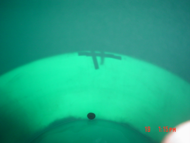

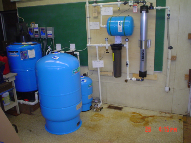

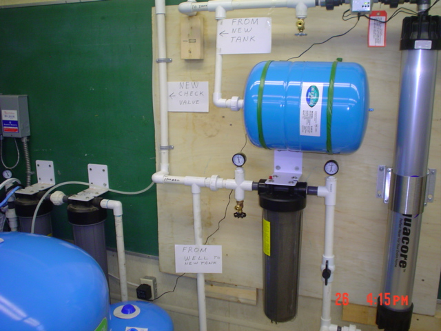

This is the setup we use now, gives us crystal clear water. Filters down to .014 microns which is smaller than bacteria so takes that out as well. In the green tank you can see the before and after, what a difference.

Thank you! We have one filter before tank, but as I said, it fills in two month and the drop in water pressure is siginificant and also the cartridge sometimes pops the seam.
I connected farmer's hydrant to the line before the filter, horse can drink unfiltered water and same is true for garden watering.

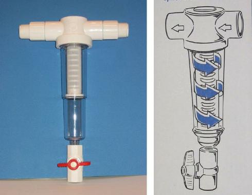

I talked with a plumber on saturday and he is going to come out and see if we can install a permanent whole house filter (see pic below).. He said he could get it in 20 microns and instead of replacing the filter you just backwash it when needed..

thatguy -- the filter you posted the pic of is what I have in my house. The bottom is connected to my outside faucets and the normal outlet at the top feeds the inside of the house. Filters decent and to clean I just run the outside faucets. There is one negative -- it is low capacity. It takes a small quantity of sand or dirt to clog it. After some big rains my new well put out enough sand that the filter would not flow any water in the house. I basically would need to flush it daily. Also these filters can not handle mud very well since they clog easier. Particles of sand or fine rock will let some water pass but mud will just clog it quicker. Just mentioning this since I have it. I am considering a full size sand seperator for my system if the sand does not stop or reduce in the next year.
