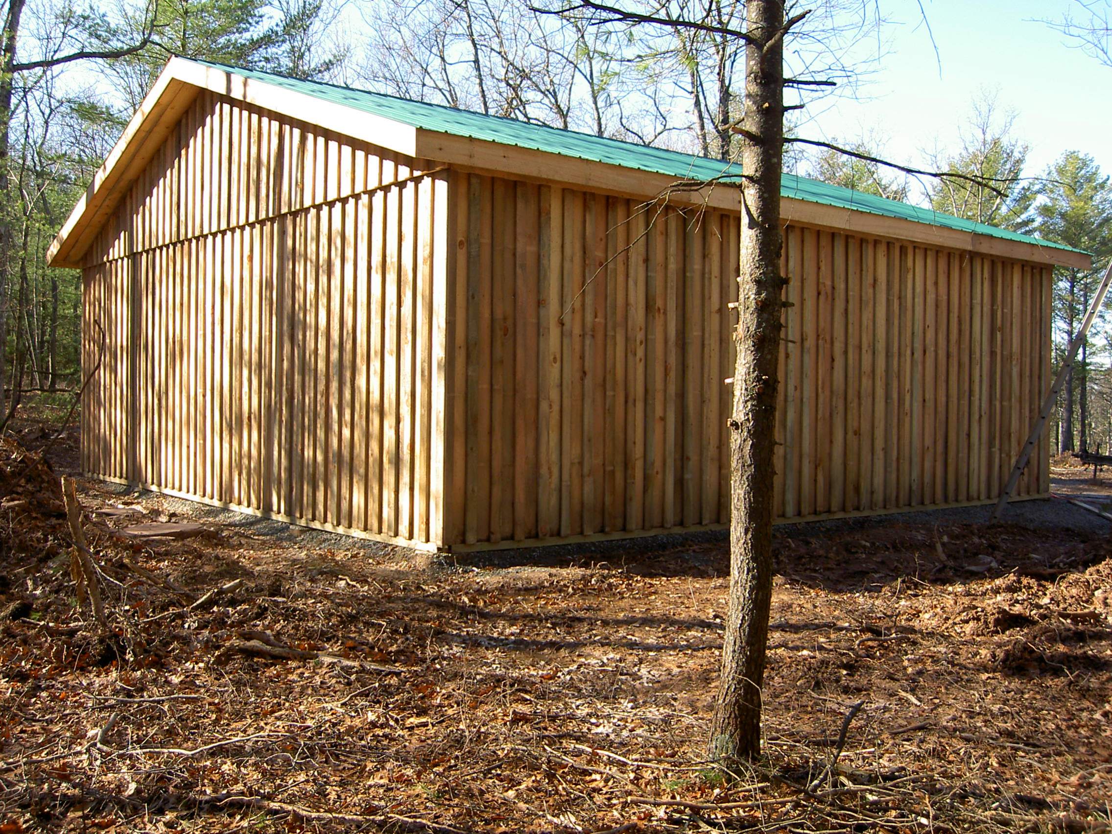

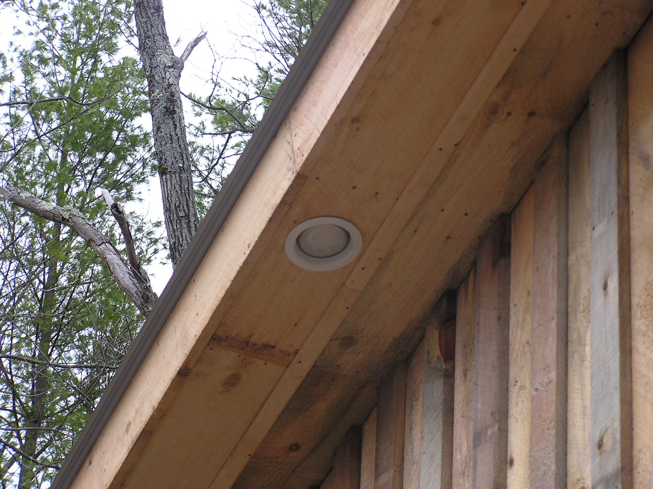

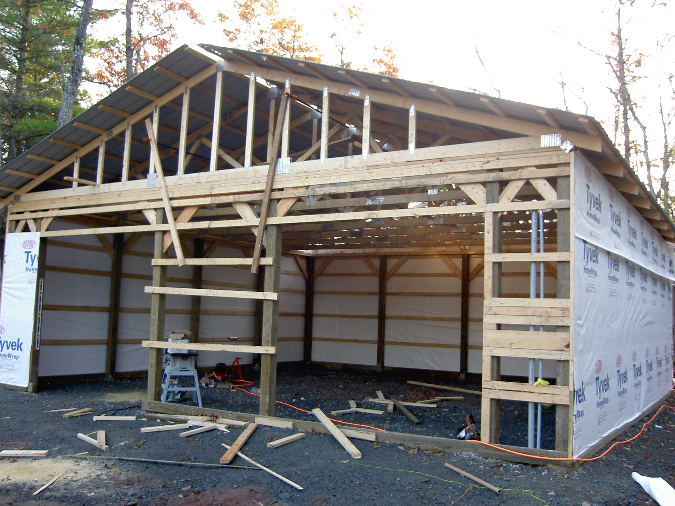

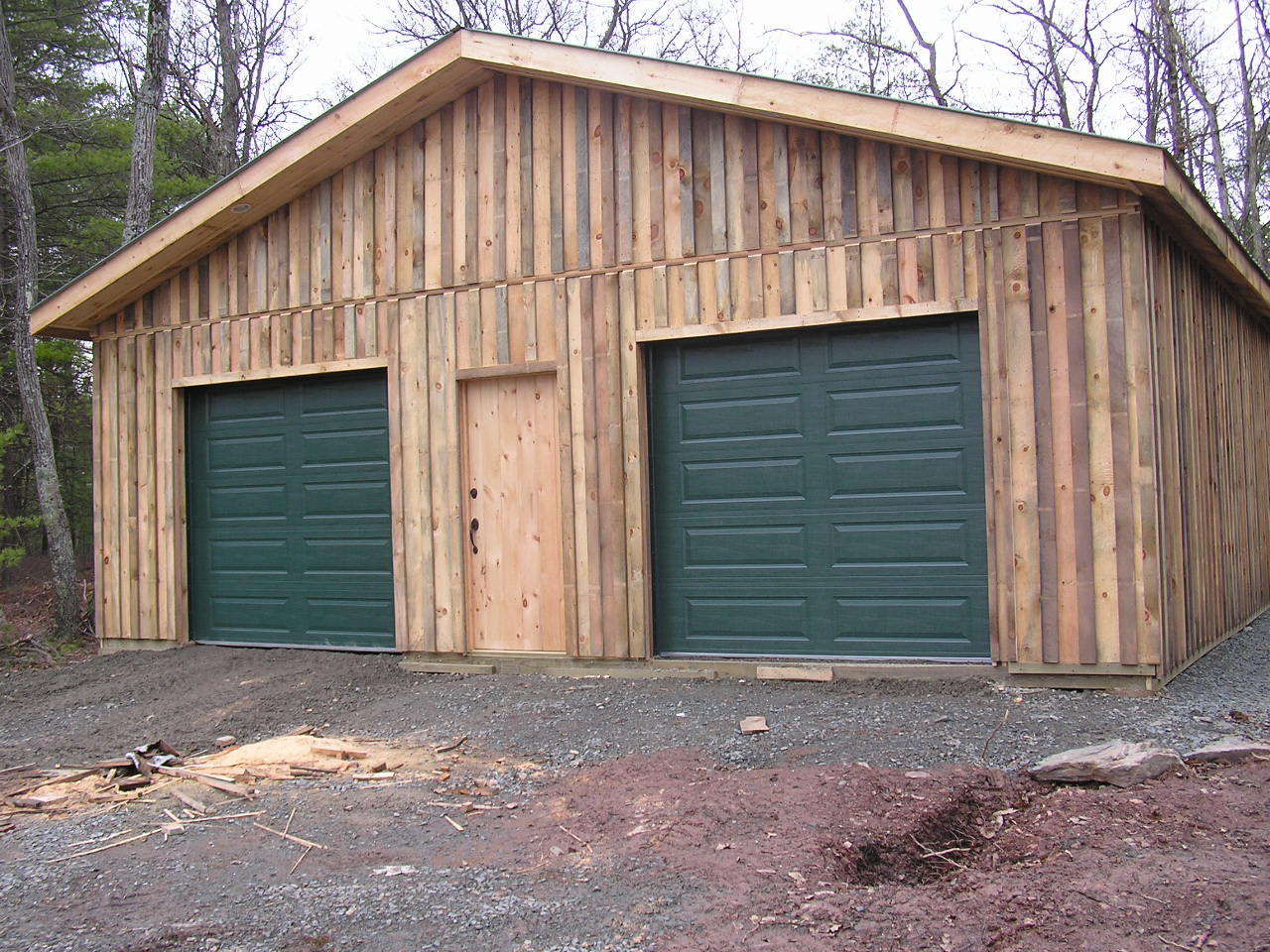

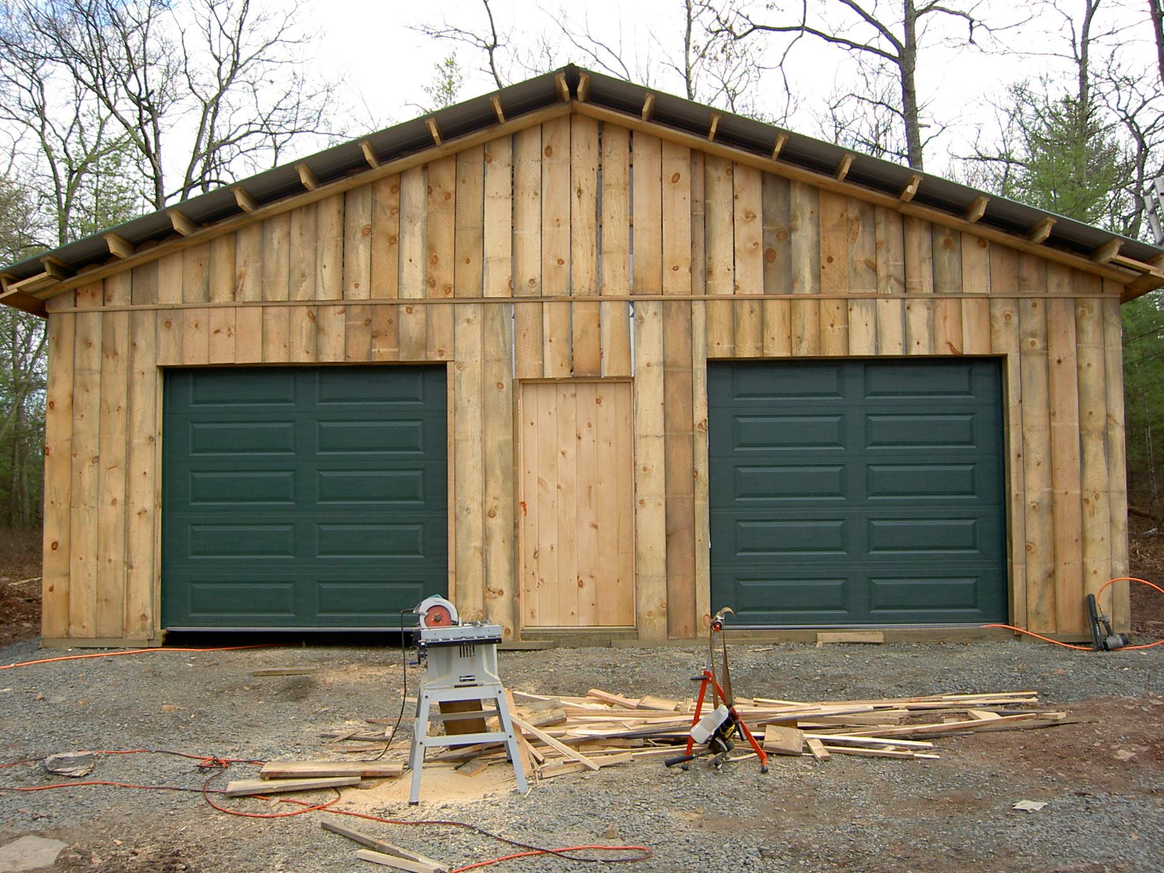

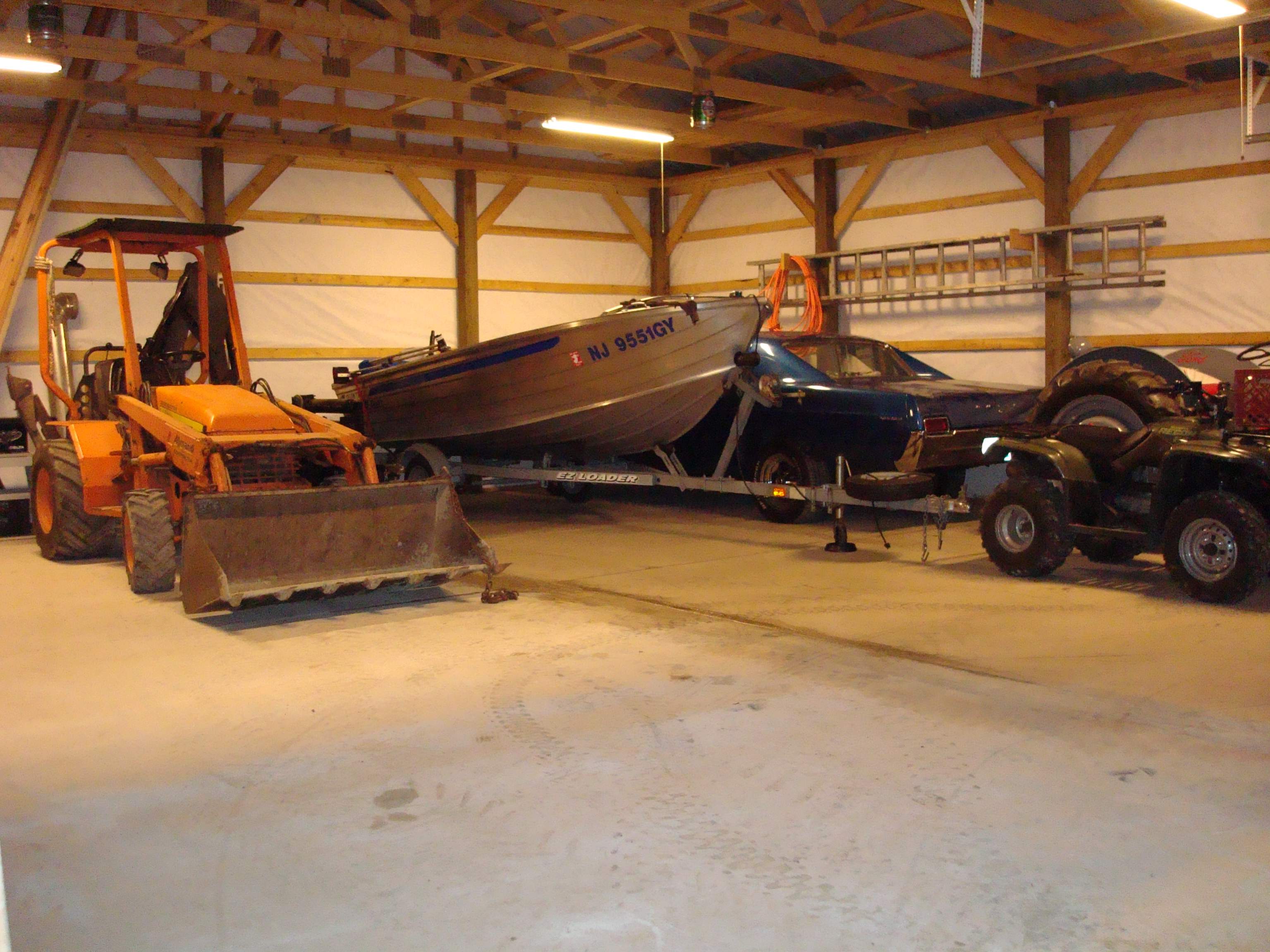

That's mine :)
Sorry if I deadeant post picture in the order I built it .
