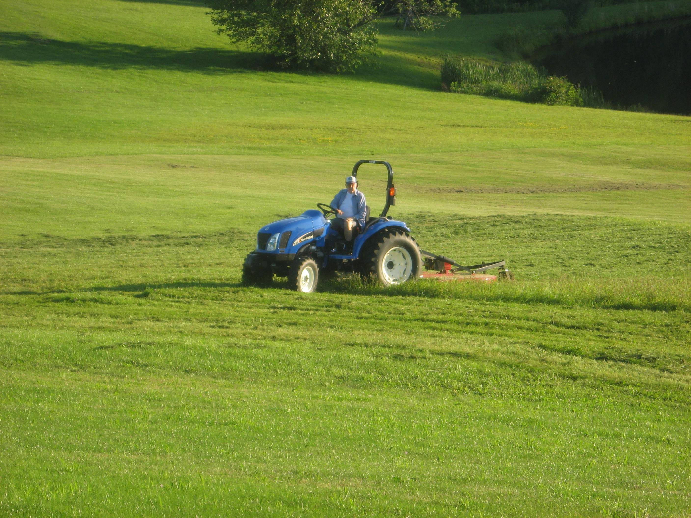

I have R1 ag tires and have never beat up or dug any ruts in the the ground in 5 years and my rear tires are loaded and I have a fairly heavy tractor. Here is my Dad brush hogging and we have had near record rain this year. My neighbor has a Kubota with ags and a finish mower-same thing his yard looks great.
They pull great in the snow and I have never had to use chains and won't-I hate putting them things on.
