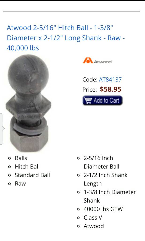

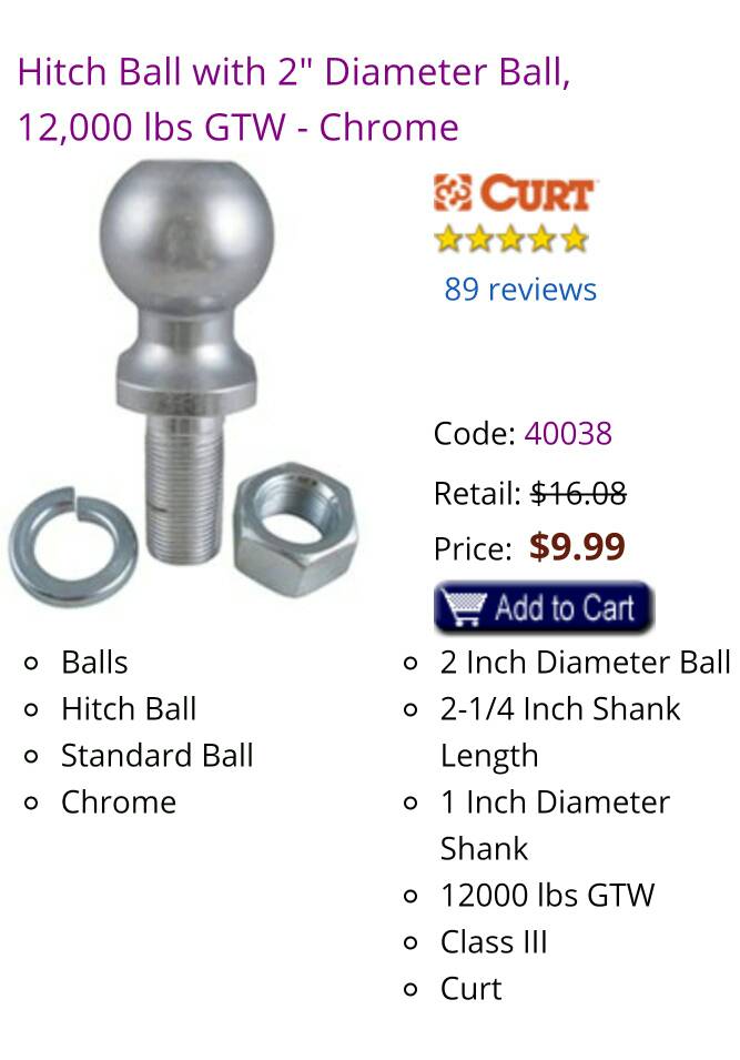

The information you present in post #9 and #11 highlight your apparent unfamiliarity with ball, and more importantly, trailer coupler weight ratings. What you now say you were trying to point out was poorly presented by someone purporting to be a trailer sales guy who presumably has the ability to accurately steer buyers in a safe direction. I'd like for somebody to post a photo or link to a 2" trailer coupler rated for 12K lbs; I'd happily eat crow.
For 2 5/16" there's this:
