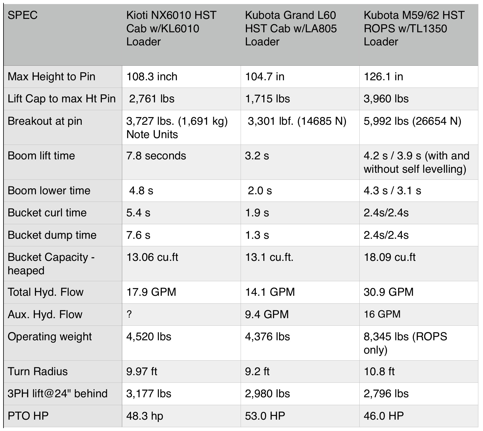

Our Kubota M59 seems to lift within specs. It is rated at 4000# at the front bucket pins and half that at the bucket lip. Last Fall I picked up a 10 foot length of 30" concrete pipe by dangling if from chains running from the bucket hooks over the bucket lip and around the pipe. Then carried it with the bucket curled half a mile to where it was to be used. There's not much guesswork on the weight - that size pipe weight should be 2190 lbs. I was careful to take my time, go slow, and not let it get to bouncing - but that load is just within Kubota's operation specs. To the surprise of the swamper - and to my own relief - the tractor handled it without strain. Steering and balance seemed not much different from normal.
Over the years I've noticed that where this loader could stand improvement is in the bucket roll-back force when the lip is held in the neutral horizontal position - that's the most common position when sliding the bucket into a pile to load it. The bucket roll-back force in that position is adequate, but that's all it is.
I see no simple reason that roll-back force couldn't be designed to be a lot higher. After all, it's a local force out at the tip of the loader arms and doesn't stress the tractor or loader mountings. It might be deliberate though - for instance the real limitation might be the strength of the SSQA adapter. Maybe I'll look at that....
Hmm....I just looked at the "specifications of the loader" on page 7 of the operating manual where Kubota shows drawings of the geometry they used to calculate the loader forces. The drawings of the bucket linkage geometry are not correct, and that means any force calculations based on that geometry are also incorrect. If that page originated from the design group, it would help explain the odd weakness in the bucket roll back force.
Oh well, I guess it doesn't really matter. That's all theoretical stuff and worth what it cost. There's plenty of muscle in that loader for anything we've wanted done.

Several points,
First most of the postings reference compact tractors. They are NOT full frame/chassis tractors. Think about where this weight is supported. Typically it is the bolted joint between engine/transmission, sometimes an additional reinforcement toward the engine front.
Honestly, a ton should be a maximum lift pin weight. It was noted, machines designed to lift are configured entirelly different. I have two lulls and a hyster. They are full frame machines, weight borne on chassis, not engine/trans components. Reach the max limit you can obtain, you will then own a two piece tractor, a mirror will produce the responsibie party. Manufacturer will likly claim abuse. Court dockets abound with similar dispositions.
A word about ballasted tires. Too many presumptions here. Folks tend to accept for granted, proper levels, but what material was used? And to what volume.
Calcium, beet juice, antifreeze, washer fluid, tap water, produce different results. Do you know what concentration was used? Are tires filled to 75 percent? Ever confirm? Ever look at the chart to know how many gallons each tire contains? Know weight per gallon, your solution concentration?
Lots of folks making presumptions, My tires are loaded!!! Really? You were there? I just checked tire level in a tire because liquid fill valve had aquired a small leak. The tire was filled to +90 per cent. Are both tires filled to same level? This isn't a fun job. Did the novice with nose buried in cell phone get it right? I know, I believe you, your tires are "loaded"

I am glad the L series tractors don't lift more. I think that they are already too light for the amount they can lift. Using the tractor safely on less than flat ground is touchy. I've got filled tires and a heavy box blade for ballast.

Where are the curves from the other brands?
Only place I have ever seen lift curves published is in the loader manual.
and since I have only owned kubotas....I havent seen other brands' manuals....so dont know if they are in there or not.
Even the kubotas isnt published online anywhere that I can find
   / Why are Kubota FEL's so weak? #51
Kubota is the only manufacturer that posts loader curves in their manuals as far as I know. New Holland states lift capacity for the Workmaster in a table at different heights at the pin and 800 mm from the pin.

I believe Kubota to be the best designed, built, and fit n finish tractors on the market. To that end I just bought a L3901 and so far I am happy with it. One thing that does stand out though when comparing this model to similar models from other manufacturers is the FEL is weak. Kioti has a ~1800# rating LS even more than that. My 525 is 1150#. This is basic physics so how are the other manufacturers getting so much more lift, has to be higher operating pressure or larger cylinders since they lift to the same height. Also I doubt this is an oversight by Kubota, they are too well thought out. Maybe they just realize this size machine should not be lifting more weight than this? I have ballasted rear tires and have had them come off the ground when being too aggressive with the loader, I can't imagine what it would be like with 50% more weight out there. Anyway is there a reason Kubota chose to limit the FEL by so much other than they are trying to save us from ourselves?
This is totally anecdotal, but here's what happened to me when going to test an L3901 TLB at the dealer. I wanted to make sure the the loader and hoe could handle the loads and materials I was expecting to work with so we tested the equipment on the back of the dealer lot.
First, he only had an L2501 without the hoe. I tried to lift maybe 500# of wet sand and ended up on 3 wheels. Turns out there was no ballast at all, not even in the tires. I asked the dealer to find me an L3901 w/hoe and thumb to test, otherwise I wouldn't feel ready to make the deal.
On the 2nd try we tested the L3901 with hoe and thumb. Moved at least 1000# of wet sand no problem. Used the hoe to dig in some rocky soil and move a few rocks using the thumb, at least 100# each no problem. The hoe as ballast made all the difference when testing the bucket.
Anyway, part of my point was that i was much more confident after testing the equipment at the dealer. Now, if the grapple would finally come in I can take delivery.
So only Kubota and New Holland publish this info? No one with a John Deere, Mahindra, Kioti etc receives this info?
Sales brochures seem to really spin this number. Seems to be like pickup truck tow ratings.
