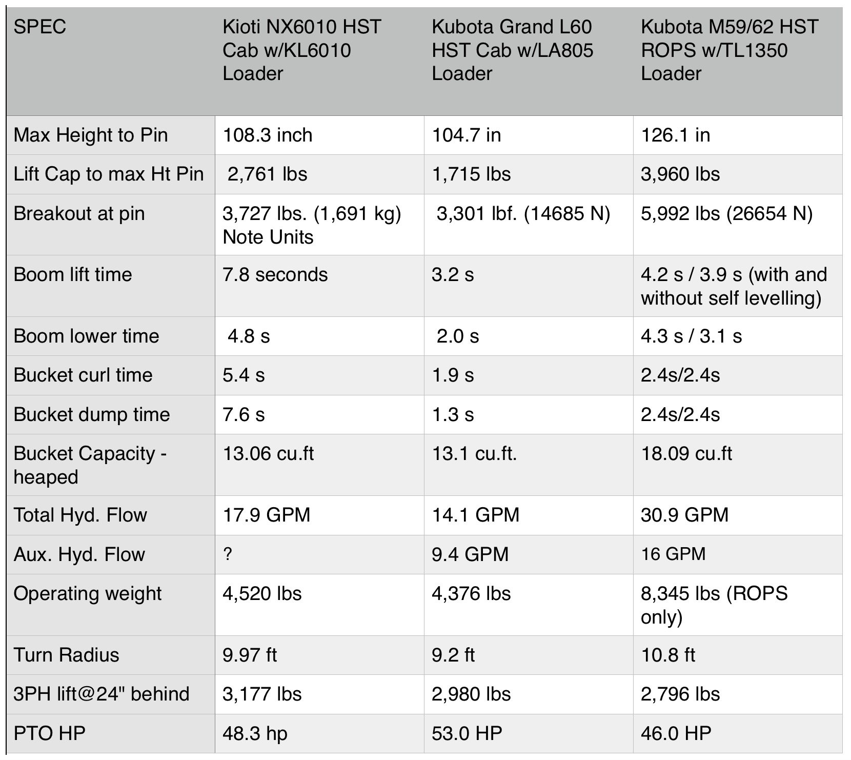

This thread has a pretty catchy name for a thread title: "Why are Kubota FEL's so weak?". Every time I read it I can't help but chuckle with appreciation - it's a question in the same spirit of questions like, "Have you quit kicking your dog so much lately?". A kind of question that may not connect well with reality, but it earns a solid A+ on emotion.
But just so no newbie stumbles on this thread and thinks the original premise is factual, the "real facts" show that the FELs for all tractors are all more similar mechanically than their advertising departments would have you believe.
And it's probably a safe bet that every single loader out there is designed to lift every pound that the tractor will support. Regardless of brand. The truth is that after figuring out how much the tractor itself will support, there just isn't much that the designer can safely change. What they gain in one place they lose in another.
If it really makes a difference to anyone just how strong a particular loader really is, then get a graph of the lifting curve for that loader. There is not much doubt that every loader on the market has to have had a chart like this made during design; today it would be engineering malpractice to manufacture something as potentially hazardous as a loader without doing this type of simple graphical analysis.
Most of the loader/tractor companies then publish loader curves for the loaders they sell. John Deere and Kubota both do - and their loaders are about as different as two can be and they still come remarkably close in specs. Here's an example of one of Kubota's. The thing to notice is how the lifting power curve is not at all a straight line; it varies a lot with the position of the load and the height of the lift. That gives plenty of rein to an advertising department bent on flogging their own brand.
rScotty

I completely agree. I seldom run into anything that I can’t lift and when I am on the edge on weight/height capacity I worry more about stability side to side than lifting capacity. Lifting ratings down low are much higher than to full height.

I'm going to do a video on this shortly, but we are starting to see companies making geometry changes to pump the spec sheet numbers. They are giving up reach and height in exchange for a bigger number. Every design choice is a compromise. Reality is, there is less of a difference between loaders than you would be lead to believe.

That is a really good chart on the loader. Notice they say nothing about torsion or twist resistance (and none of the manufacturers do.) The Nebraska tractor lab has nothing published on torsion that I can find either. Loaders get used for SO many things, whether appropriate or not, and a lot of people shopping for tractors see the loader as a very large part of their use and application. So there really should be specs on torsion. How much off center load will it handle producing how much angular deflection in the loader frame ? What is the max allowable ? What is the point of no return where a twist becomes a permanent disfigurement until repaired? It would be much improved insight into the tractor/loader capability to see those stats and to see them tested.
   / Why are Kubota FEL's so weak? #75
I kinda doubt manufactures would want to publish something like that. I believe tractor/loader sales is dog eat dog, and manufactures would just as soon you didn't really have tools to make too detailed of a comparison.
