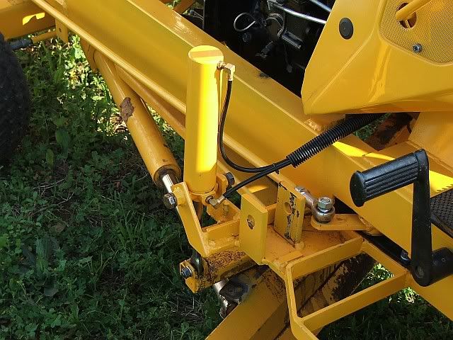

Don't want to hijack the thread but Thanks Rob. Yes, the grader blade angles as well as lowers and/or tilts. There's a cylinder on each side that's independantly controled for ground contact. The cylinders are just in front of the rear up-right for the FEL.
This is a shot of one of the cylinders with the FEL removed.
