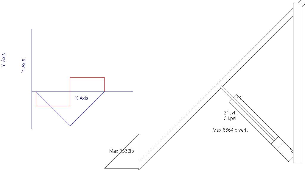

Here's my vague understanding, based on trying to do beam calculations for trailer frames. Looking at a VERY simplified loader design, the red graph represents the forces acting on the loader arm, while the blue line represents the stress. (Anyone with more engineering than my paper napkin doodles should feel free to correct my terminology). The most stress in the member is at the point the cylinder contacts the arm. This is the point where the most strength is required. To either side of that, the arm can be tapered, due to the lower stress levels.
In the example of running into immovable objects (hitting a rock while plowing snow, for example), additional forces in the horizontal plane come into play.

you got it, but I can't help you with terminology either, since my ME degree is from the Czech University:)

pretty nice graphic representation of what they called the D and the M line at school... No idea what the official name is in English though..
What some engineers tend to forget, is that not just the stress from bending acts on the fibers, but also the shear forces of the very same load that causes the bending...
Just think of an overhead rolling crane in a welding shop: the consoles on which the crane rails rest, which are welded to the vertical poles of the building, are maybe a foot long. They can easily take the bending, but the material tension caused by the vertical shear force is about as much as the tension caused by the bending moment....

Anyone mention " steel Grade " ? I'm sure there is better steel used in some loader frames due to the thickness of the material. My TL270 looks like it is less than 3/16 at the bucket end. The curved formed surface no doubt also adds strength also.

Rus Geek,
What you just posted was a classic Shear ( the red line) & Moment (the blue line) Diagram , complete with free body diagram of a beam with a point load, assuming axial tension or compression in the beam is not considered.
Nice job!
