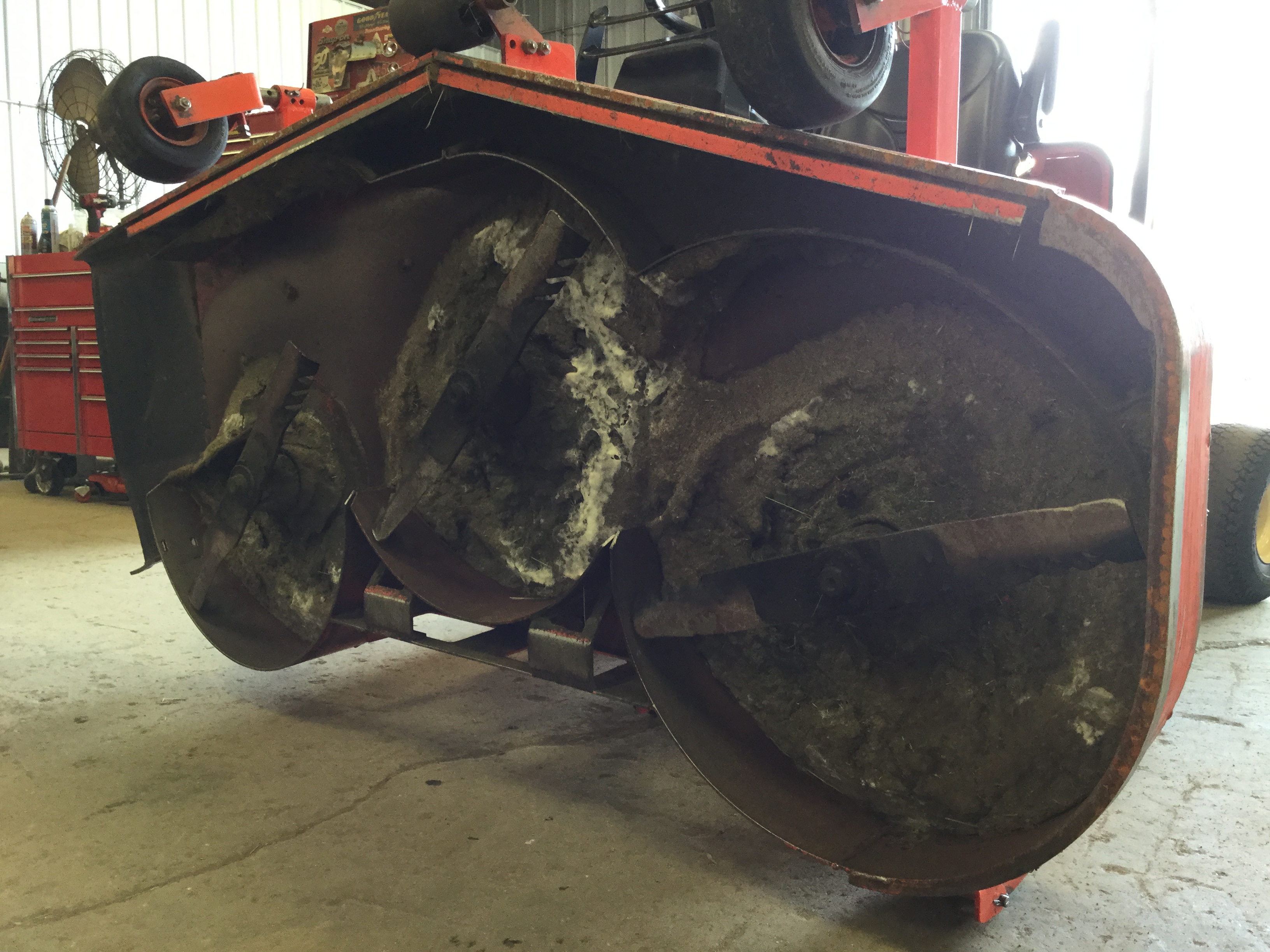

What does a baffle kit look like or do? I can't find any pics around.

This shows a picture with the mower deck flipped up?ou should have this baffle bolted to underside front of deck (the one end towards the discharge chute is little bent in-someone most have hit something) Some of the earlier models did not have this baffle and could be added for the $80.00. you other objective is to make sure the deck is mowing level front to back this adjustment should have been done at the dealer when it was new (takes a special gauge to do this). We have on a couple of units, bolt a セ thick rubber to the front of the deck hanging down approx. 3 below deck IMG_0776.jpg

I "think" the baffle kit controls the clippings under the mower a bit longer for re chopping and primarily controlling better discharge of chopped up grass instead of clumps. :2cents:

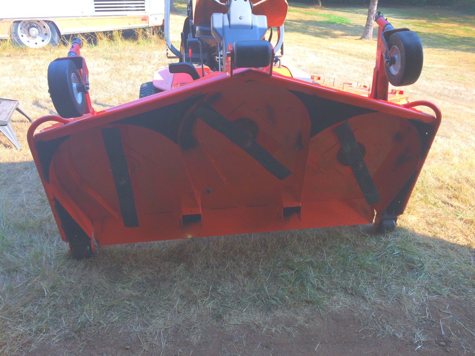

This is how my new RC72R-F30 (70050-94572 deck shell only) replacement RD deck from Messick's looks like:
(I have since added the missing two rear middle anti-scalp rollers)
The old RD deck shell was worn from having being operated too close to the ground by the previous owner, but it's still repairable and I will eventually repair it and see if there is a demand for it?
