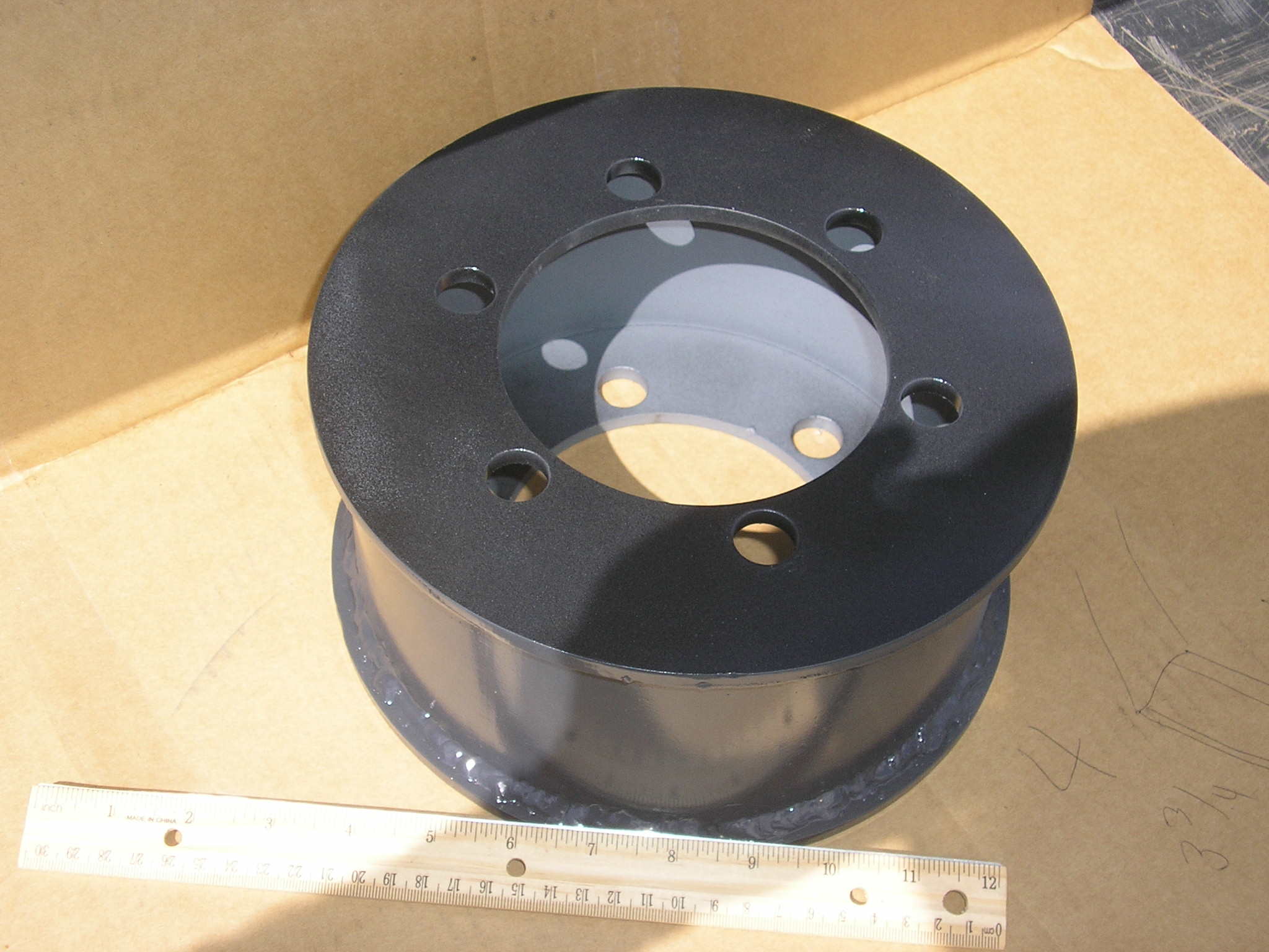

I looked at wheel spacers online and ebay had some for sale but not to fit my tractor. I emailed the supplier and we had a chat. After the conversation I decided to make my own. He stated in the conversation that people think he charges a lot but after doing mine myself and considering a guy in business, they're not overpriced.
Mine are 4" which makes my tires even with my 5' mower. Steel plate and 8" steel pipe. Made the pattern and had a machine shop cut out the plate, 4 ea, for 25 bucks apiece. I did the rest....work great.

Pictures of home made:
Looks good and I'm sure it works well but I would've went with a thicker hubs so you could tap them. With 1" flanges you could've added the female recess for positive location and support on the axle side. Knock out the studs and thread the bolts into the flange from the back side. Then, you could put the male boss on the outer flange for wheel. Reuse the axle studs or you could tap the outer flange and bolt the wheel right to it.
Clear as mud right?
