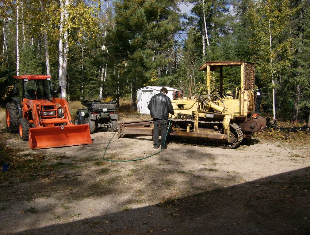

It is a 300 km haul to the dealer. Will wait till spring and then go to dealer with any warrenty issues. A week at camp, can't wait to get Christmas over.

Hey Nick - nice crawler! Bet that winch will pull a house. What vintage machine? What brand? To borrow a phrase from another thread, "now that's a tractor ! ". Picture looks like it has an extra wide front blade ? Like the Kubota too - do you trailer it back and forth to your camp? Have a great week.

Back from camp. The dozer is a 1958 International TD6 and runs like a charm.
Put about 10 hours on Kubota snowblowing and no problems with chain. The chain is a new one from TSC and no breaks and I did find some rocks to throw. Must have been orginal chain giving me the grief.
