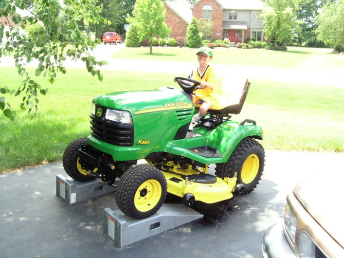

See attached picture of my new X595!
My "helper" is posed and ready to put it to work!
Simply amazing the difference in torque and smoothness between the diesel and the kawa engines. The Yanmar diesel wins hands down!
