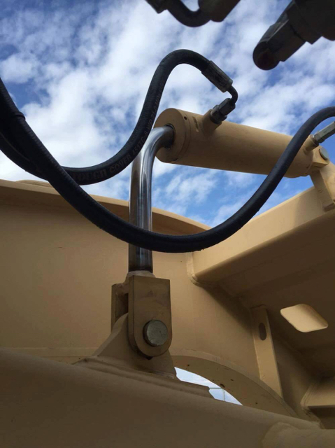

About the motorcycle fork thing ... inverted forks are much stiffer o'all. This is important to reduce twisting forces/effects that on FELs etc are absorbed/controlled by loader arm rigidity (vs triple trees) that few bikes have similar to. (btw, remember tweek bars? :rolleyes:)
That bent rod in the pic above ... it takes a lot of o'load to start such a bend, progressively less as you go from there. Looks like whatever load bent it just ran out of travel at that degree of 'oh s__'.
