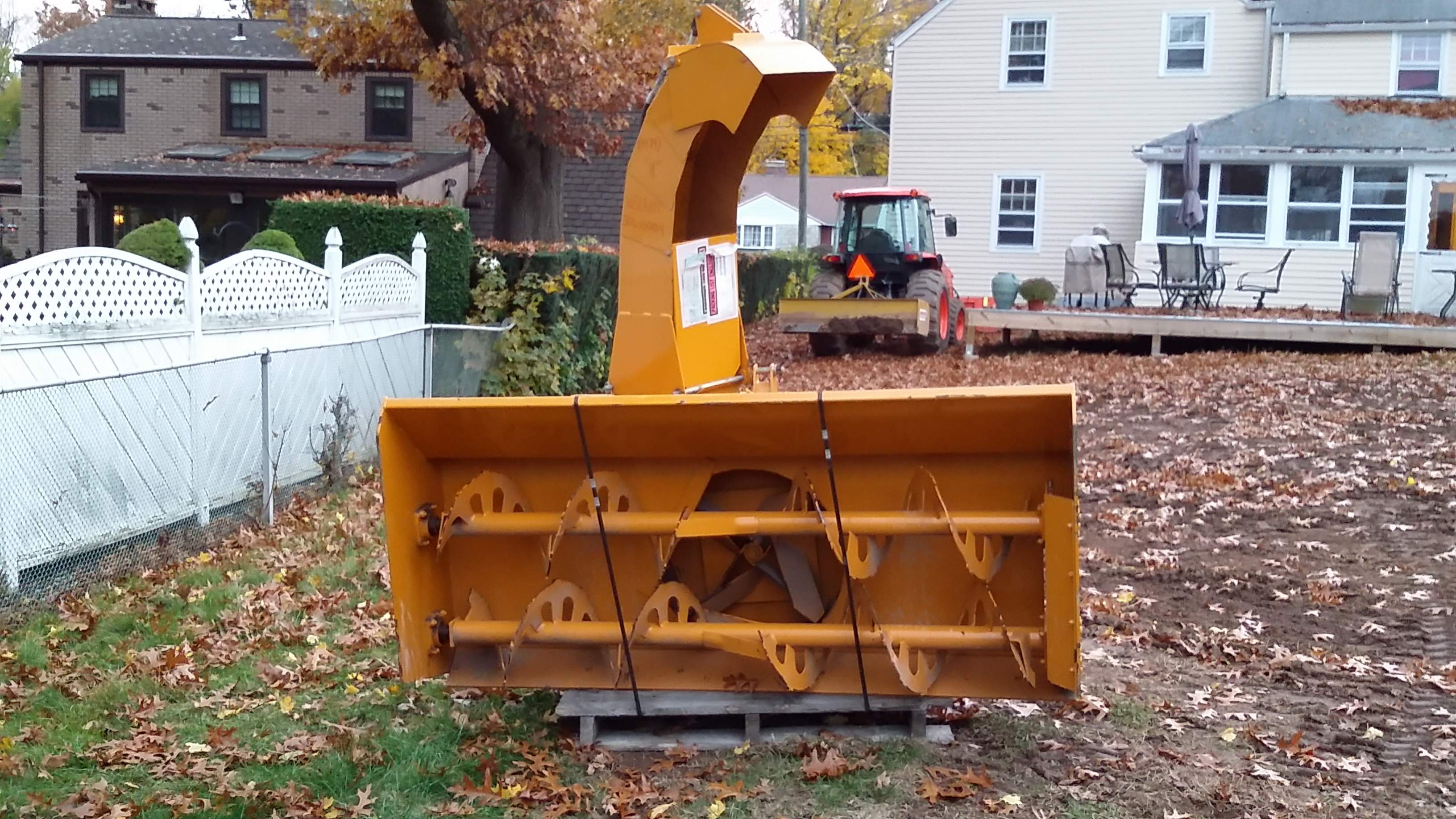

Sounds safer than getting off with the PTO spinning.
I'm pretty sure its 2,000 RPM going the opisite direction of your 540 RPM rear PTO. You'll need to slow it down & reverse direction to put a standard 3pt blower on the front.

It's a c ount r r clockwise blower so I'm good

I'm trying to find out which direction my mid pto turns it's on a l series 4740 tractor each dealer gives me a different answer and I need to know what's correct as I'm gonna mod a snowblower but only if the pto spins the correct direction !!!! Gees can anyone speak from experience not I believe so !!! The blower is counterclockwise as I thought the kubota rear was counter but the front was clockwise !!!! Here is a pick of the tractor and the blower View attachment 398295
Don't know how much you have sunk in that blower but if EITHER the rotation direction or rpm are wrong I'd sell it and start looking for a front mount unit that you don't have to modify. Search using "snow blower tractor mounted" as it is surprisingly elusive to just say snowblower, etc. You might even like Power Pak - Hydraulic Power Source for Skid Steers | Loftness which is an hydraulic motor driven blower made to mount on the front end loader skid-steer plates.

Or toss your cell phone under the tractor and hit record, run the pto, then check the vid.
