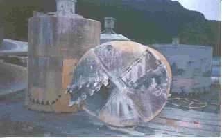

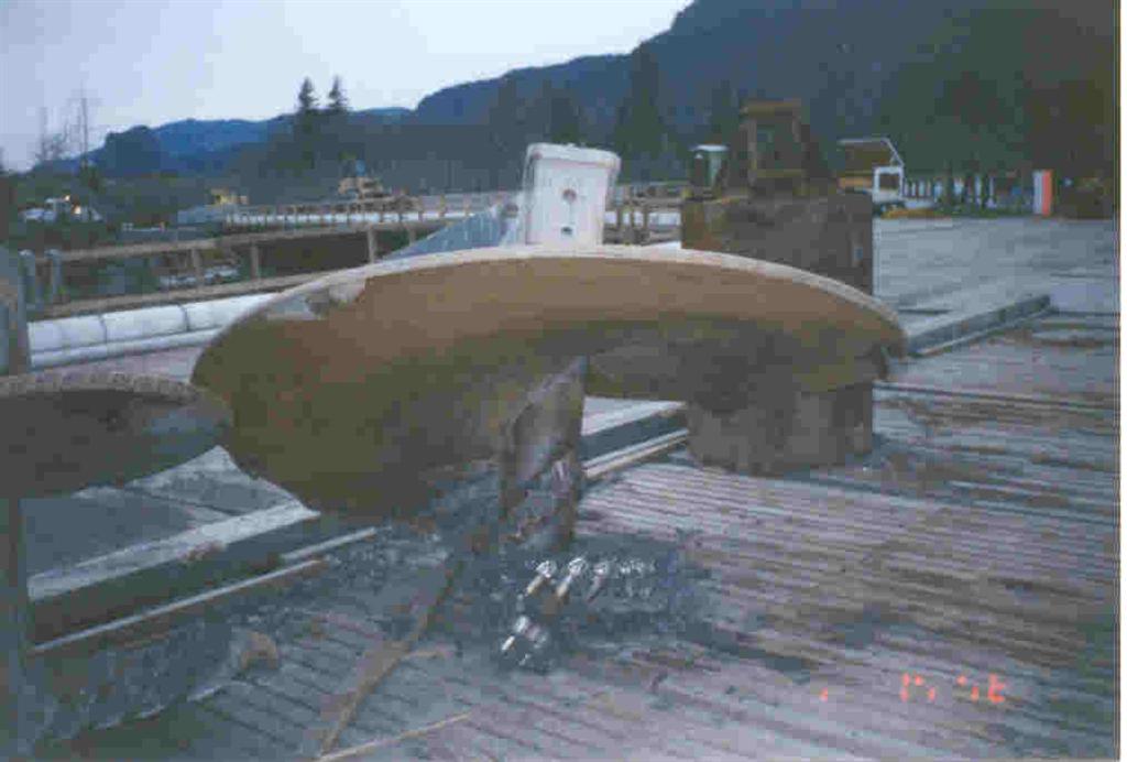

These were very slow going piles. We used a hydraulic vibrating hammer to drive them. No impact hammer at all. In the second picture I posted above the crane to the left of the derrick, the red one with a blue boom. Was gearing up to drill out the inside of the pipe. Here are the augers we used. The large hole saw looking auger really got a workout drilling through the rock. It was amazing how many carbide teeth we went through!:shocked: The Kelly bar was powered with a 750-HP diesel engine.
