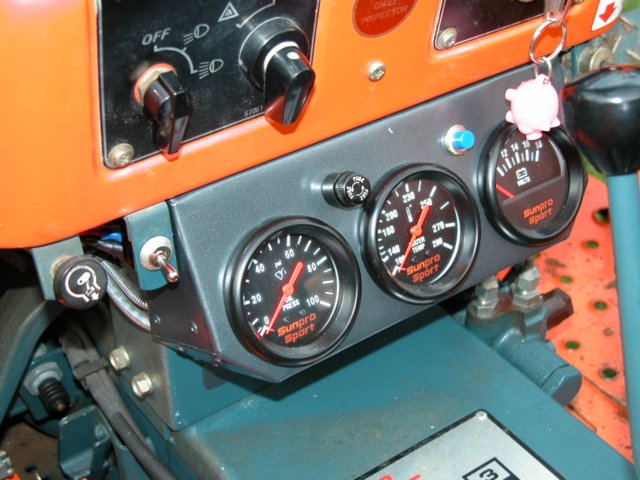

   / Why does oil light come on? #6
Not long after I got my used B8200, there was a thread on triple gauge sets that some TBNers were talking about. I invested $13 in a set- oil pressure, voltage and coolant temp. I made a "console" to mount them, but installing them was easy. I just installed a tee were the oil sender switch was, and bingo- very useful, I think. Seems to me everyone should have such information about how their engines are working.
   / Why does oil light come on? #7
That's a nice looking install! :thumbsup:

   / Why does oil light come on? #11
Nice setup. What does your oil pressure run hot/cold/idle/max rpm? Or just simply the range you normally see? What coolant temp do you stabilize at? Thanks. Philip.
