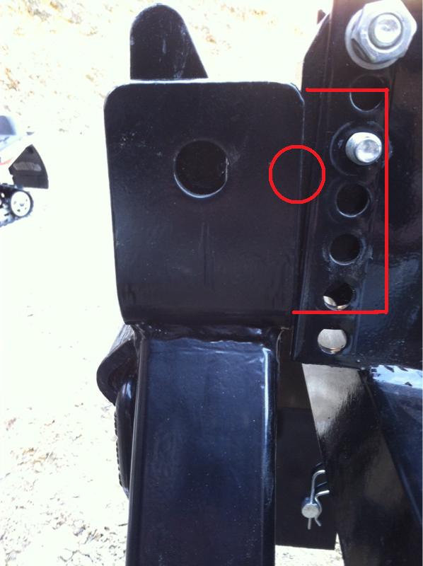

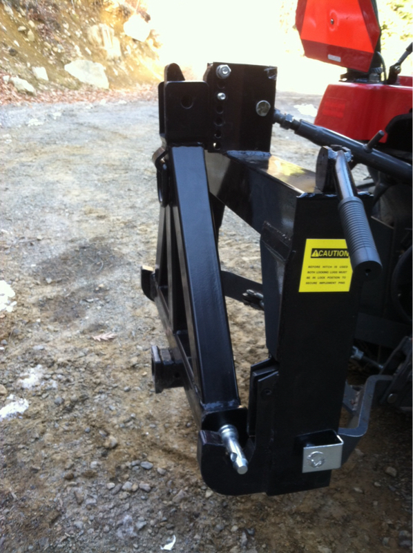

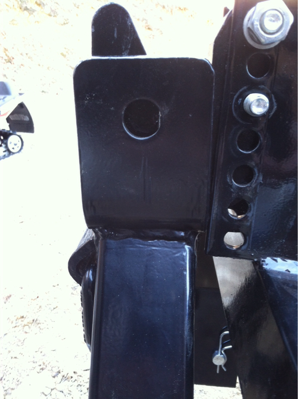

OK, I bought a saltdogg sand /salt spreader that instead of putting it on my F-150 truck, I've decided to put it the 3pt. hitch. I ordered a 3pt. hitch receiver and a 3pt. quick attachment so that I can blade the gravel road and quickly throw on the spreader. Both are supposed to be cat1.
So as you can see from the pictures, the top hook doesn't line up with the top pin. I can't lower the hook or it won't fit in the area to hook the pin. What is wrong or did I screw up somewhere? Can the hook be cut? Sure but it'll weaken the strength.

I'd modify the top link bracket before I'd consider modifying the hook. Maybe just cut some off the edge so it goes in further.

Implements have to be quick-hitch compatible to work. Not all of them are. Doesn't look like that receiver frame is.

You've fallen victim to the incomplete quick hitch standard. The standard specifies the pin size and spacing but not the geometry of the hook and frame. Your receiver would be compatible with something like the original John Deere I-Match with the fixed hook because it sticks out farther. I would probably drill a hole to match the hook location. The top hook won't pick up appreciable load, so that shouldn't be a problem. An alternative would be a top link like this:
Top Hitch Adapter-Quick Hitch | Agri Supply #61369
You can remove the hook and use this for any implement that doesn't match the hook spacing.

I disagree! It isn't open access from the bottom (from what I can tell), which makes it flat out non-quick-hitch-compatible. Some weld-on tabs would make it usable, that adapter would make it usable, or return/sell it and get a QH compatible one.

I've had 3 QHs from 2 different manufacturers & all were like this. It's a very common problem.
I ended up pulling off the hook welding on a 1.5-2" extension on the back & re-writing the holes so the hook stuck out further on all of em. There are several threads on here about that mod. Lots also replace the bolts with hitch pins for easier adjustment if needed.

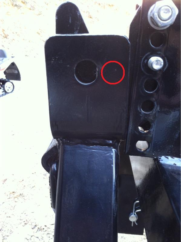

Agree to either weld on tabs and drill a new hole to make it usable or return it and get a QH compatible.
It may be a little thin but you might have room to just drill another hole for the top link pin.

Nevermind I reread your OP and retract my previous comment. :drink:

I just shaved off about a 1/4 to3/8 of an inch off the inside of my harbor freight quick hitch's hook.
It was easy just took a steel blade in my sawzall and ran right down the hook. Then took a new grinding wheel and smooth it out at the bottom.
Adding a extension to the back and Drilling new holes sounds like The best option though.

The OPs trailer puller isn't qh compatible. If it was, the top hook would be adjusted all the way down (15") not at the top (18"). Even extending the hook doesn't do it. You (he) can't move the hook down far enough to unhook it. The center post is there.
