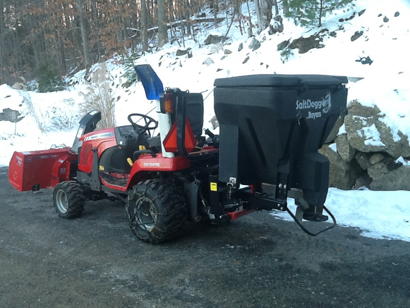

Well I didn't take a closeup but I replaced the receiver side of quick attach and all works well now.
Here's the spreader hooked up. When I park it in the house garage I have to lower the rops and I forgot to lift it before I spread the magic salt today.
