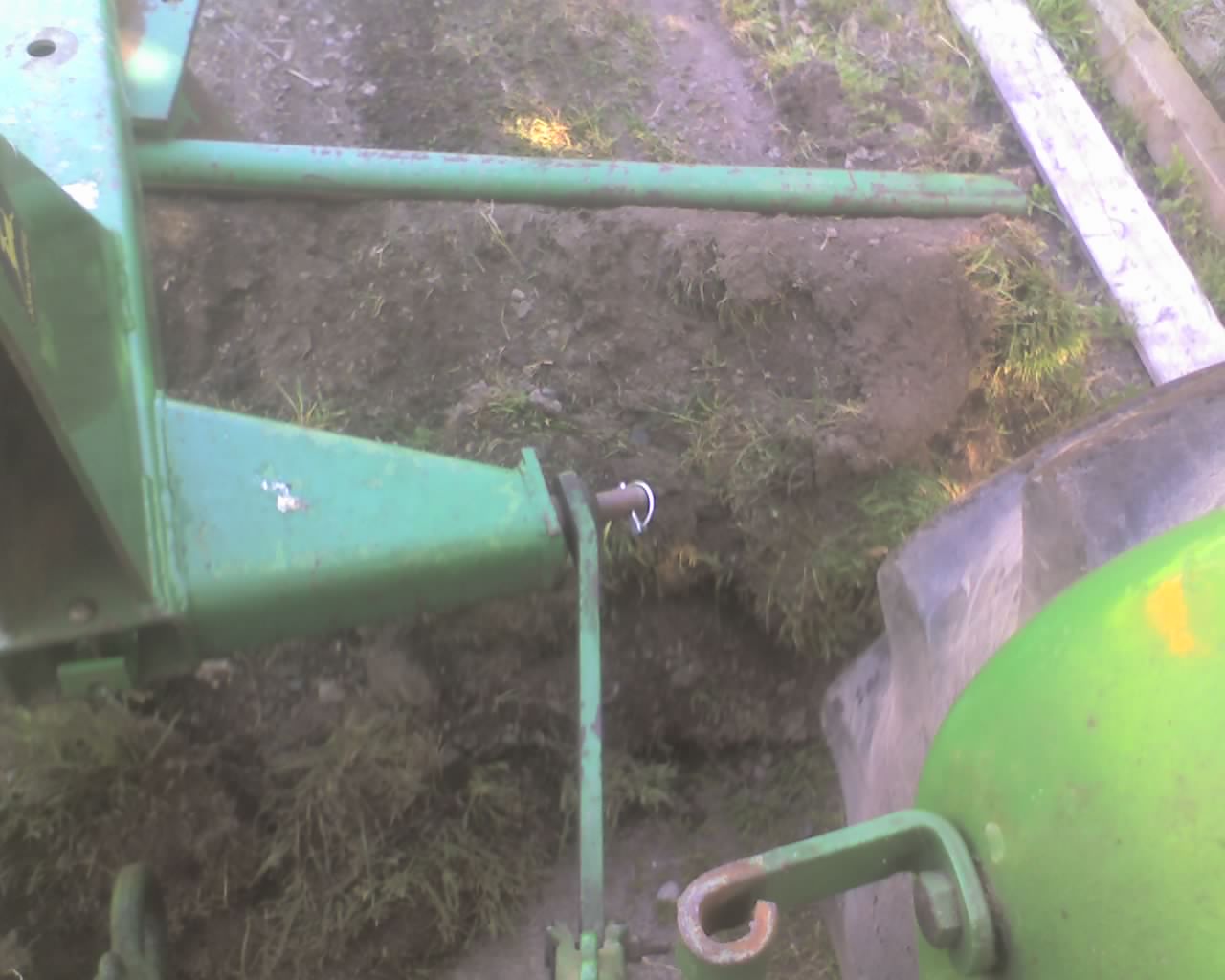

OK, got the mower swapped out for the rear blade tonight and tried some different things. The first thing I checked was the angle of the boom when I attached the RB. I had previously used it at the angle it sat when I attached it with the front support leg down. I mistakenly assumed that it sat level when unattached. The first picture shows that it actually sits tipped quite forward. I tipped the RB back and tried grading with it. It performed much better and actually would get a full blade of material.
After I finished, I spent some time looking over the blade and discovered that there is 1/2" worn off the cutting edge and that it has never been flipped. Picture 2 shows an end shot of the cutting edge and picture 5 shows the front.

Well, back to blading some today. It's cutting well when I'm off the main drive. I figured out that the main drive is packed so hard that this blade has trouble cutting, but it still does the job 1/2" at a time. The picture is of the material in the blade while grading one of the back drives. I'll get some pix of the drive tomorrow.
You were right about the power of the tractor vs the blade. I hooked a burried concrete electrical box today while grading the main drive. The blade held up better than I would have expected. It bent one of the
Cat2 pins!:eek: I guess that's better than bending the blade.:thumbsup:

My question for play in the blade wasn't for side-to-side movement, but rather tilt side-to-side. ...
...The bolts which hold the blade to the boom are also loose, but were rusted to the point I could not budge them either tighter or looser so I sprayed them with YEILD snd eill try them again another day. I'm currently down to about 2" of tilt from 6".
I got 3 of the four bolts to tighten up. Now I'm down to about an inch of slop tilt.
