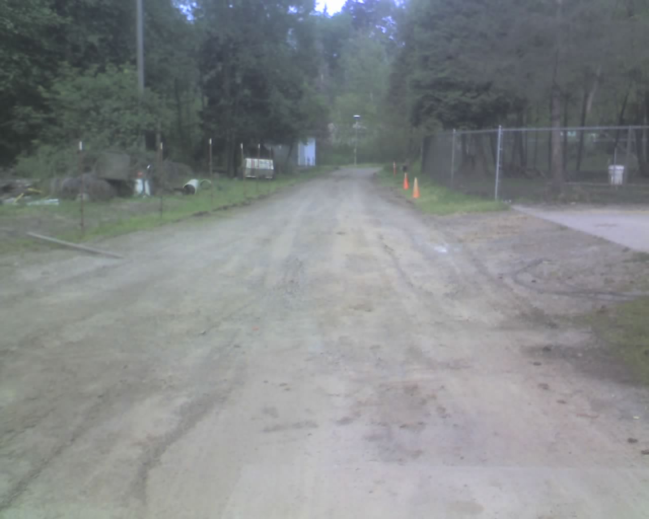

Well, I only got one picture, but here it is:

Forgot to saythat from my eyes your drive looks better than mine by a mile.And I like medium rare just tell me the postage and my check will be in the mail.Really wish I could be a part of your gathering but just cannot.Very kind of you to do this and I sincerly hope you have a great time.:licking:Dave
