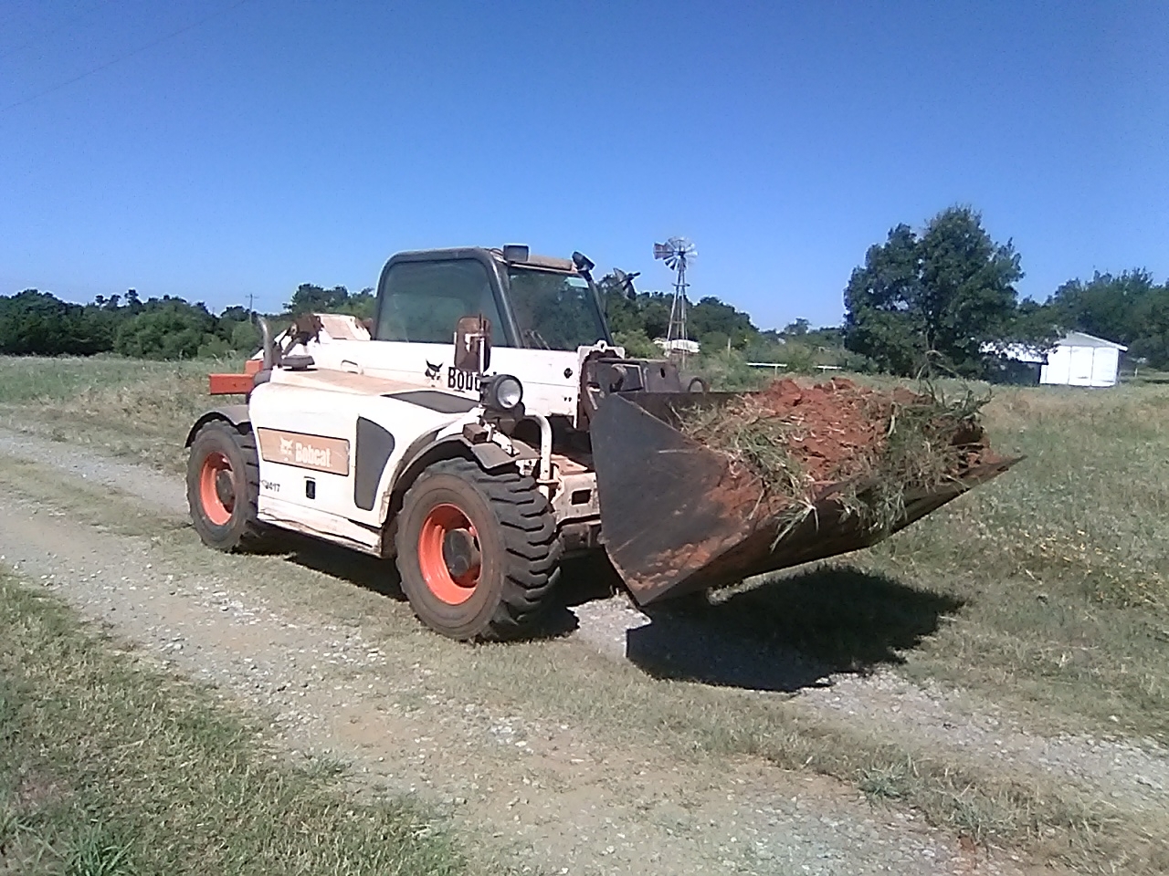

Why do you not have a toothbar on your bucket?

My take. Right now I have the toothbar on the bucket because I was ripping up a temp "road" of 2"- rock. It helps getting under the rock to loosen it. I also ripped up my garden space to redo everything.
Once that is done the bar will come off until needed again. The smooth edges is much better for 90% of my uses. Cleaning ditches, picking up debris/manure, carrying firewood or creek gravel.
