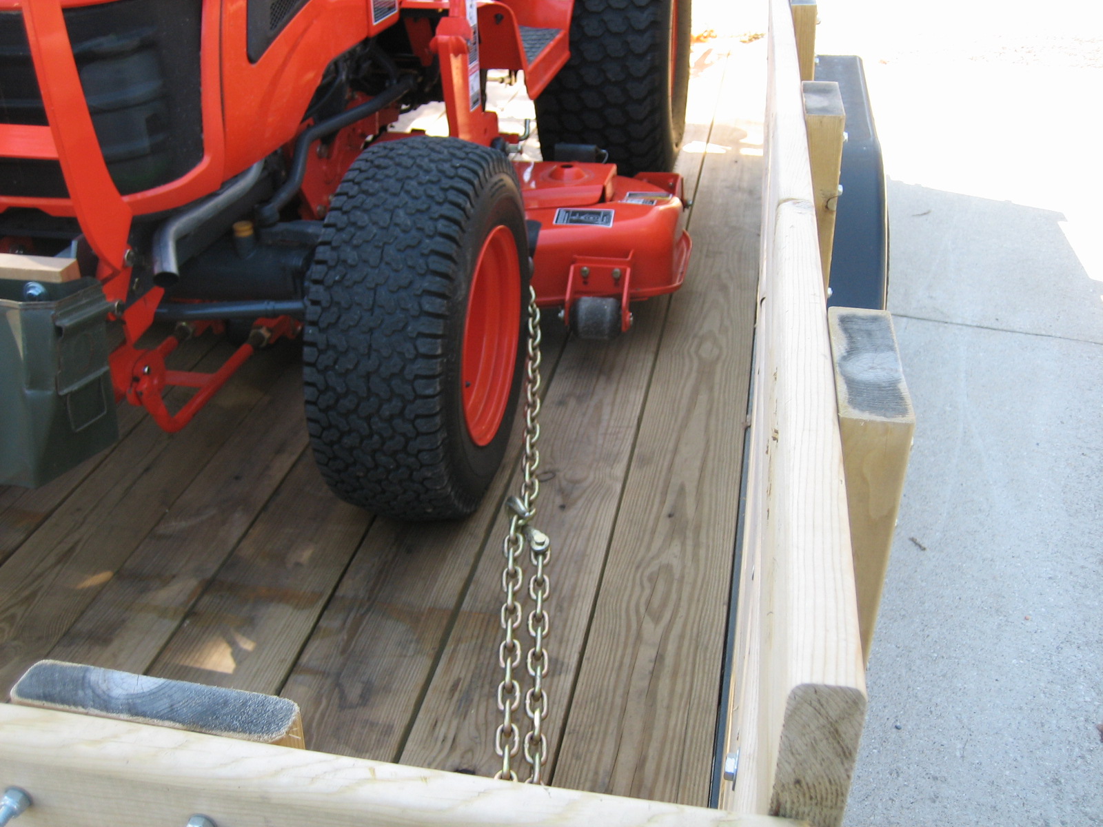

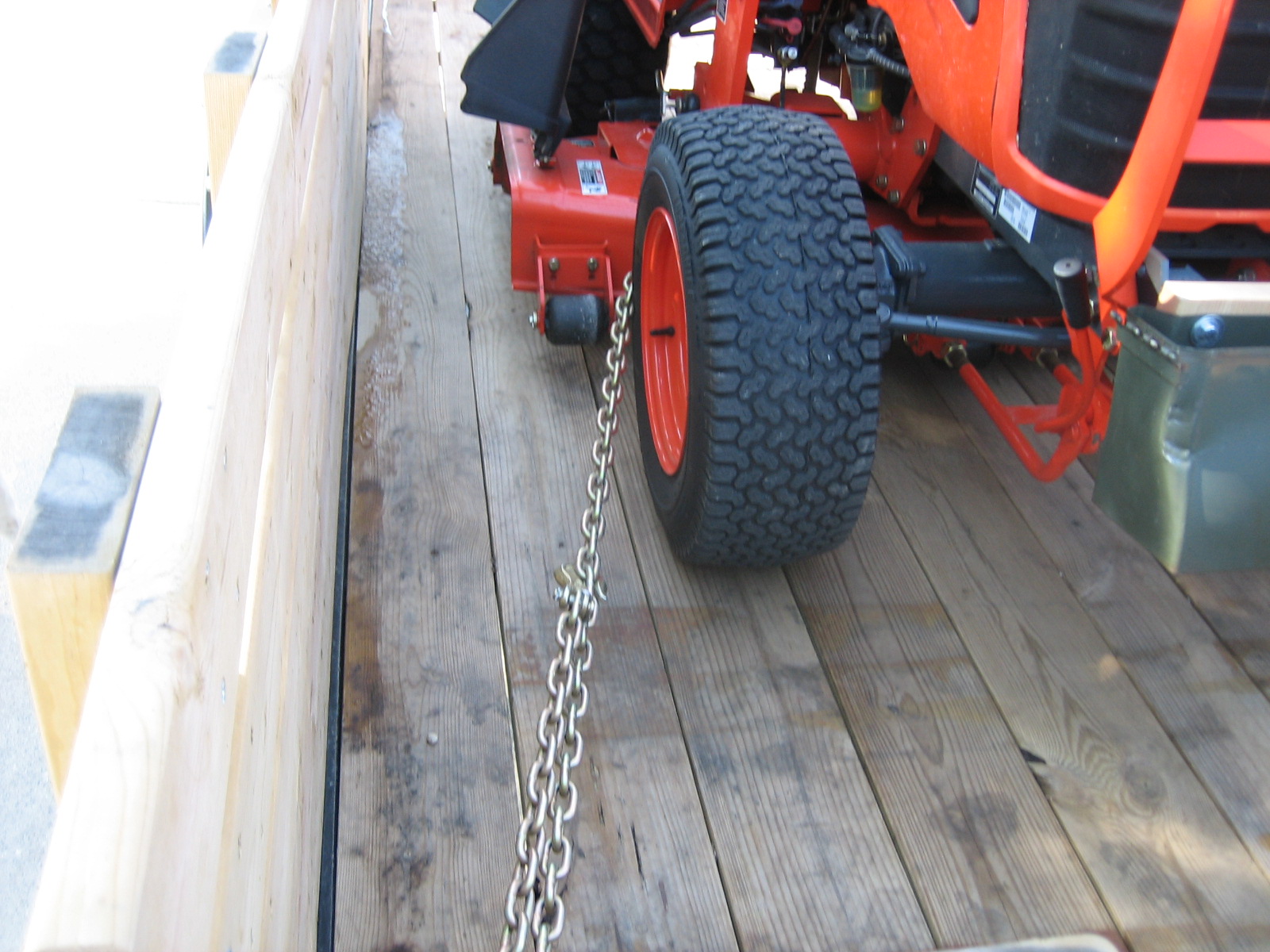

So, as I said I would, I loaded up the tractor and headed off to the nearest State Police post as a starter. Once there, I told what I want them to look at. They defered saying that they aren't versed in the motor carrier laws. The desk Sargent then called the nearest Motor Carrier Officer to get his location. We agreed to meet at an off ramp where he would inspect the load. When I met up with the Motor Carrier Officer, I asked him to look at the way the tractor was tied down. He said, " It is secured front and rear, it has an adjustable binder on the rear, it weights less than 10,000 lbs, it meets the requirement of the law." I told him to hold on, the experts at TBN claim that four adjustable binders are required. He repeated " It is secured front and rear, it has an adjustable binder on the rear, it weights less than 10,000 lbs, it meets the requirement of the law. If it was over 10,000 lbs then four binders would indeed be required."
So now we have a quandary, TBNers say four binders and the lowly Motor Carrier Officer ( the person who will be the one to issue any citations for violations) says that what I have is correct. What to do, what to do? I'm going to make a choice but I will let you guess whom I'm going with on this.
Photos showing what was inspected.

The Motor Carrier Officer is correct in what he told you. If under 10K it meets the requirement. I think most TBNers who use 4 chains and binders (like myself) do so as an added measure of safety. Don't forget that any added attachments need to be secured in addition to the tractor. Here is the Federal Motor Carrier link verifying what he told you is true.

Not so here. California requires four independant ties, one on each corner, adjustable. I have posted it here before. I contacted CHP directly for an answer; got one by phone, and one by email. They do not care if it is a chain/binder, or a ratchet strap. They do, however, want each corner secured independantly, and adjustable(binder on a chain, rachet strap). The chain or strap does need to meet strength requirements.
Ca DOT regs are more stringent than US DOT rules.
So... if you traveled cross country(Interstate) the rules may change when you cross state lines.
