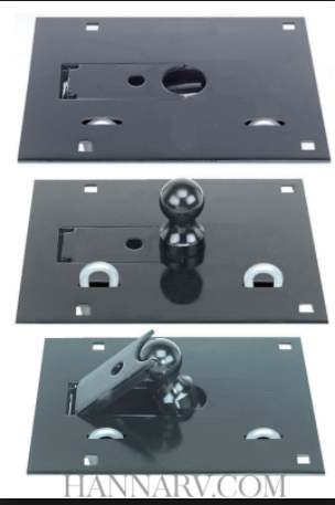

Today I've learnt that there is a difference between 'gooseneck' & '5th wheel' hitches. I simply thought that they were interchangeable terms or that they were slang words for the same thing.
Thanks TBN! :thumbsup:
Big difference.
Gooseneck, old style plate:
New style:

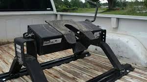

5th wheel:
