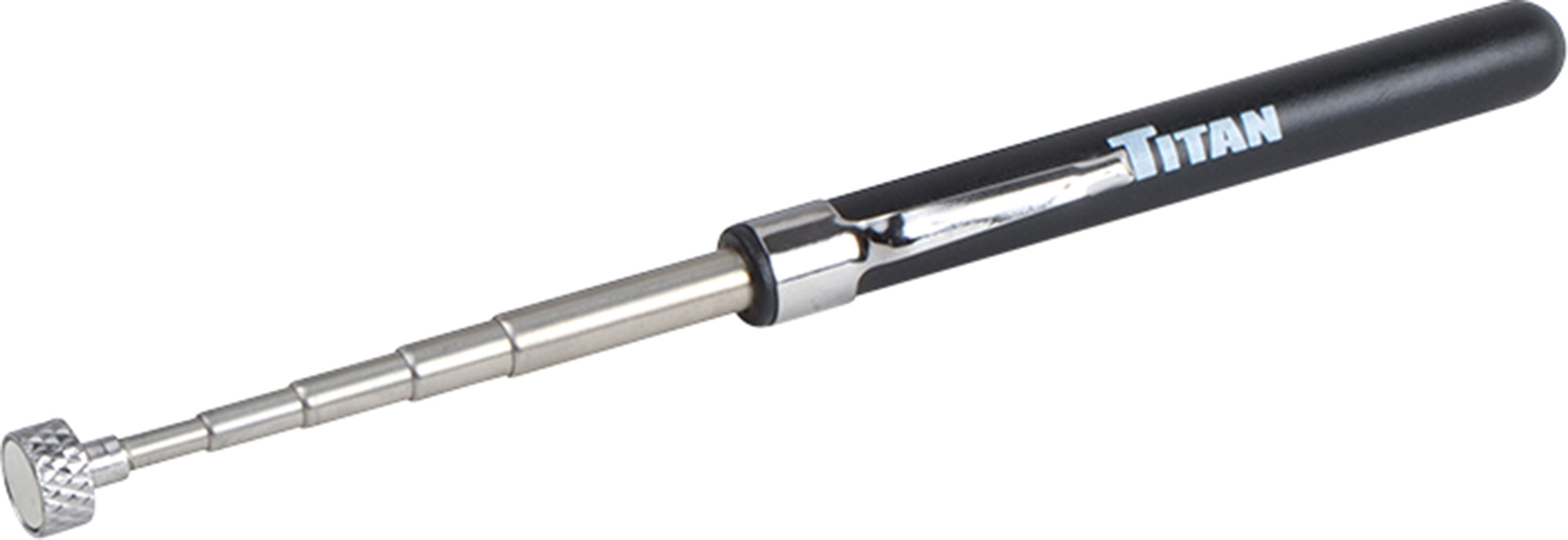

I fastened a short piece of aluminium rod to an old speaker magnet. Set it in front of the gooseneck ball, back up using the rearview mirror, keeping the rod centered on the trailer hitch. When the rod moves, stop and lower the hitch onto the ball.
Yeah, I bought a telescoping magnetic picker-upper for a few bucks to do the same thing. 3 lb Magnetic Pick-Up Tool | Princess Auto
Just put the magnet on the ball and line it up with the gooseneck, when you knock it over it is lined up. The telescoping is nice because it just collapses and I could keep it in one of the door pockets in my truck. After a couple years I just stopped using it because it wasn't necessary anymore.
