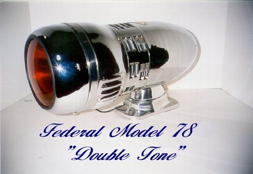

Very nice install, but where is the sound???? I like the ability to make the movie also.... how did you do that?? Is it easy for those of us that are technically challenged?? Where is the siren mounted???? /forums/images/graemlins/grin.gif When do the tulips bloom in Holland??

The siren will be installed shortly after the new interceptor engine goes in. /forums/images/graemlins/grin.gif
