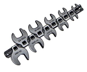

Get a crows foot and remove zerk and all. Then buy some extra zerks; you'll use them eventaully no matter what.

New tractor - obliviously you don't want to risk scratching it. I agree with DrainDondDesign, a crow's foot wrench might work.

Get you a pair of vise grips and clamp them down where the tube starts to make the bend. Put a small block of wood or even a piece of metal pipe next to the tube and pry down with the vise grips. It'll come loose.
