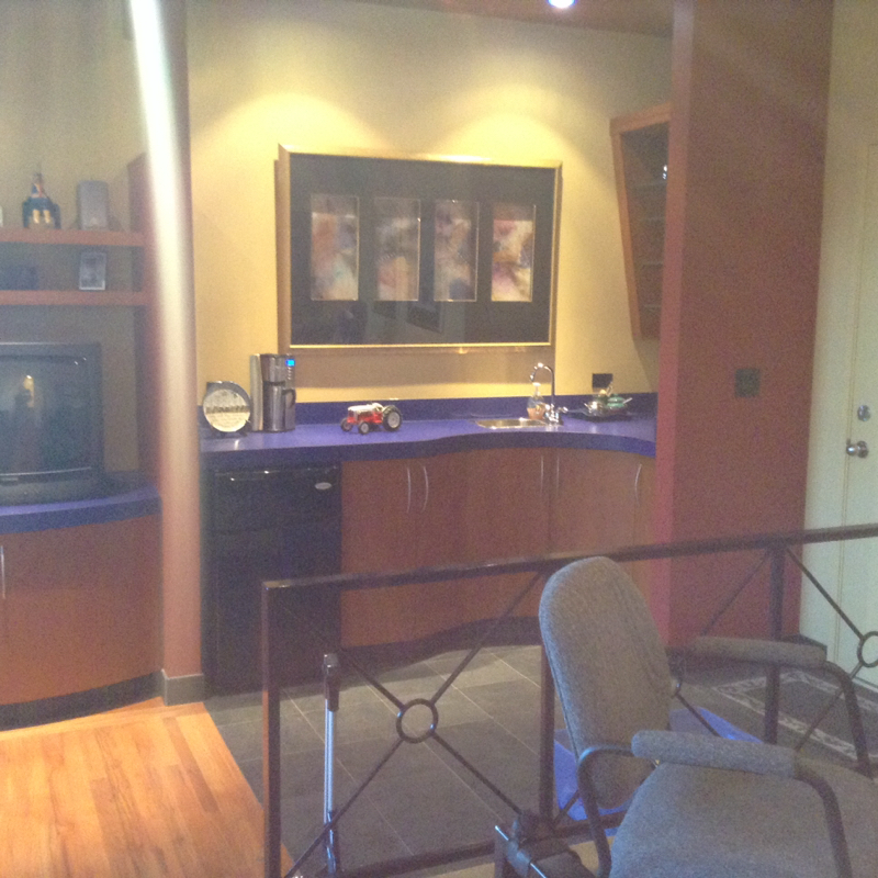

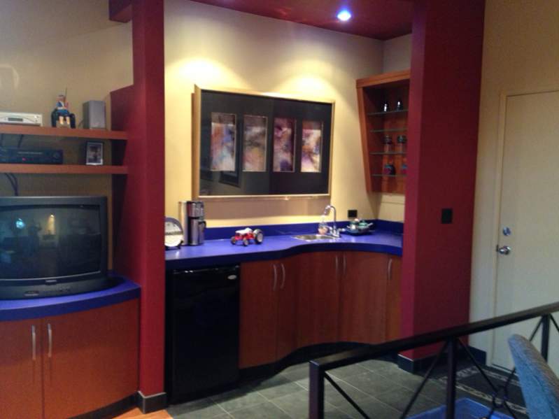

Office?? my shop didnt even have a door until a couple of years ago.
Gotta have a spot for the beer fridge:) image-4021002280.jpg
