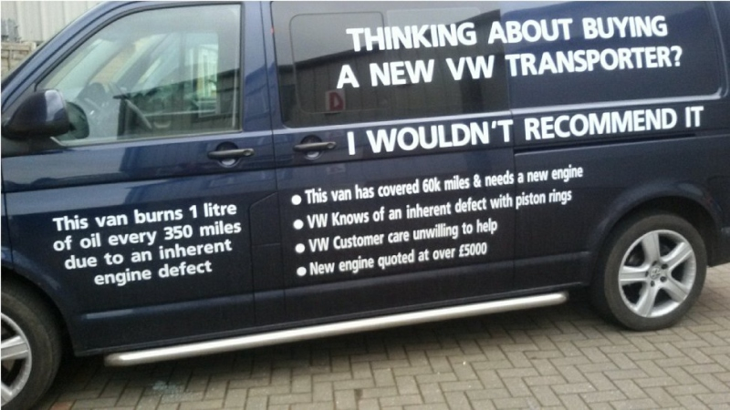

I have a less rosy view on cylinder and liner coatings: VW and Peugeot both had huge reliability issues when they relied too much on the coating, to reduce the amount of lubrication oil the scraper rings would let pass to lubricate and seal the compression rings. They reduced PM on new engines but both manufacturers had engine models that started to consume huge amounts of oil after 80.000km because the rings ran on a coating instead of on oil....
So i dont know what you call "historical" problems, but they have been around for 10 years, are still recent, and a PITA; I hope you do a better job than VW 😉
(Edit: According to Wikipedia, the VW 2.0 Biturbo TDI used Alcan or Federal Mogul pistons: I dont know which they put in the TFSI turbo gassers, but those were equally poor, my colleague had one and hated it.. why dont the Germans just keep using Kolbenschmidt?? 🤷‍♂️)
haha! Yeah our german colleagues handle the EU business, I don't have access to those programs. Thats a ring problem, not a piston one though. And a problem specifically designed and dictated to us by VAG ;)
Kolbenschmidt makes a fine piston, as does Mahle, generally speaking. But we each have our different (patented) technologies. And now we all have problems keeping our manufacturing plants fully staffed and operating. Raw material pricing is brutal now too. Tough times.
