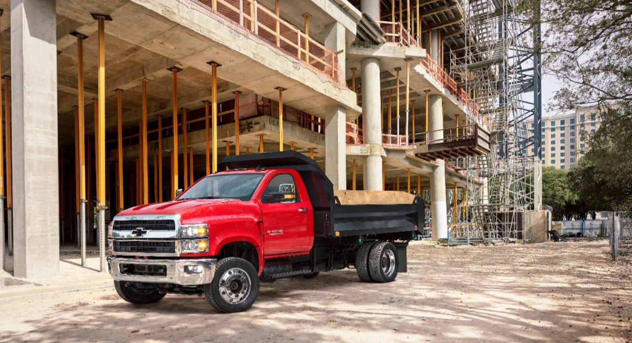

That's what I read also crashz. They are dropping their sheet metal on an international chassis & drive train. CV Series | Class 4/5 Truck | International Trucks
I just went to IH on the web and it looks like they are as you said partnered up, using GM's sheet metal but an IH grill.
Do you know if they are using the IH 6.6 or sticking with the D max?
   / Why no heavy duty Chevy pickup? #7
NEW 2020 Chevy HD, speced "properly" will be rated to pull OVER 35,000 pounds.
