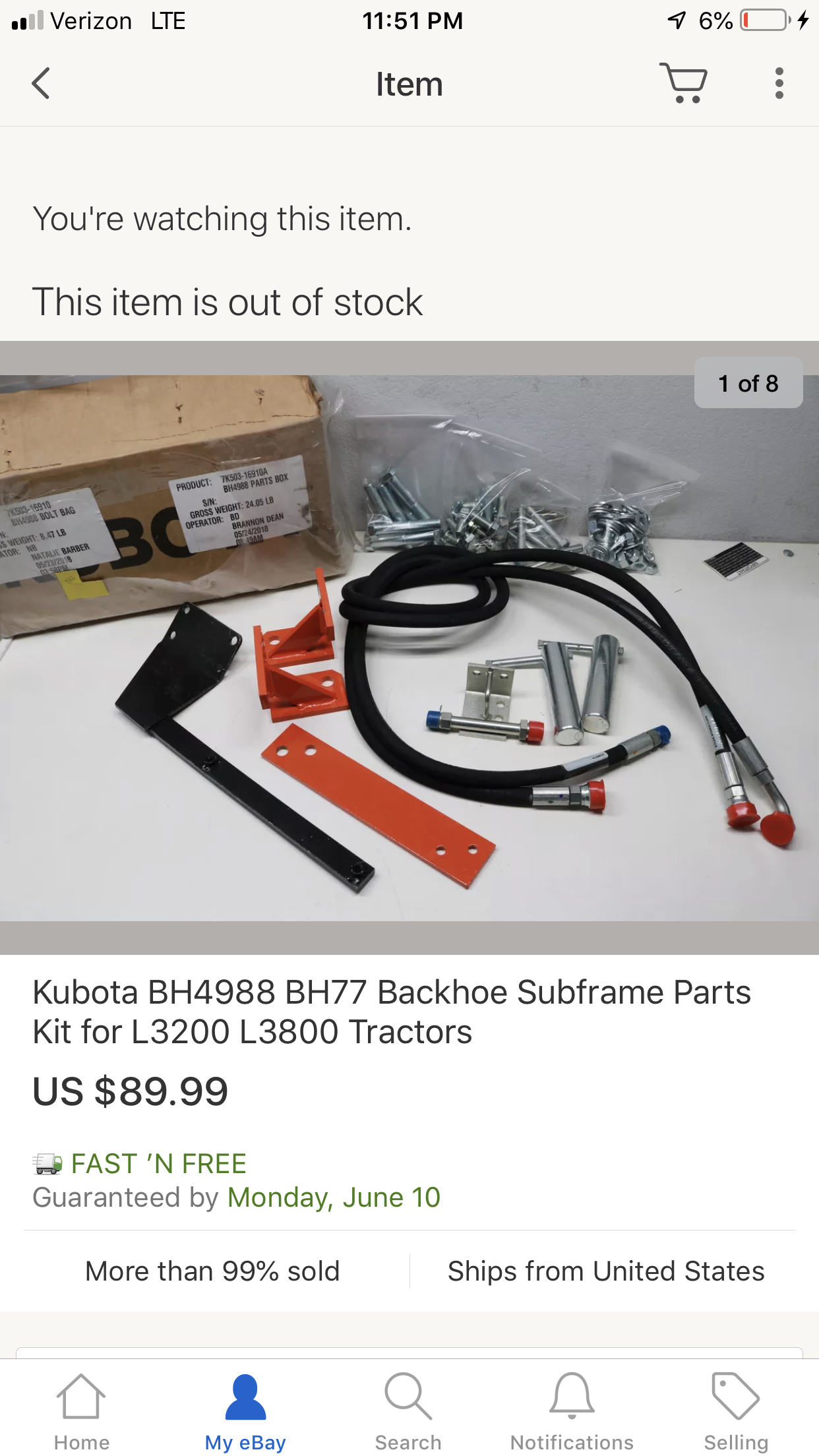

And something like this for the hydraulics.
