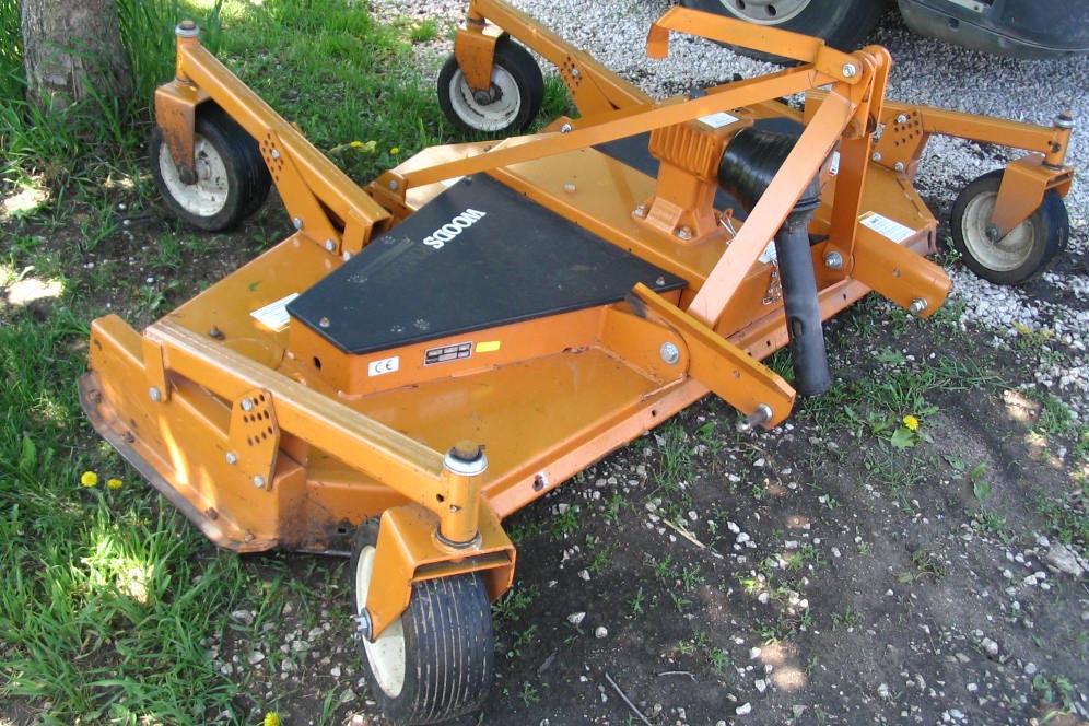

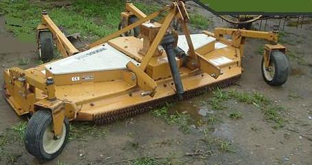

pacerron - nice post. The RM990 cuts 7-1/2' - your earlier post mentioned an 8-foot so I thought it might be a different model.
I've used RM990's for 15 years. I got a fresh one a few years ago - the older one is semi-retired but still works fine. The 990's do it all - with low maintenance cost.
