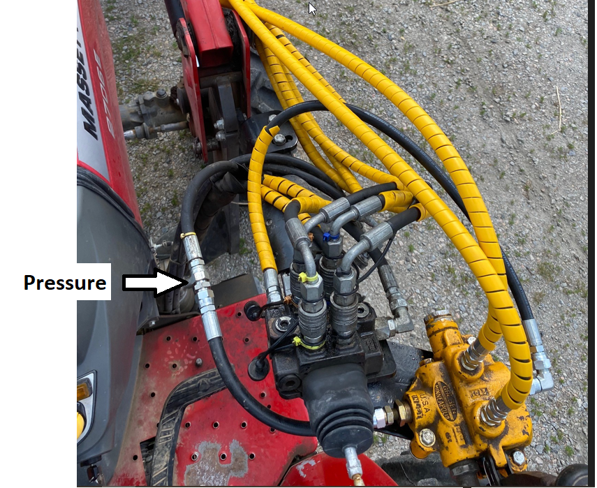

I bought a rootrake grappler, my tractor is really basic 2706e and I don't have the rear remote. I was given a wood splitter valve 24 GPM flow through so I took my hydraulic pump pressure and send it to my new single action valve took the out and send it back in my original tractor function valve should this work ? I tried it and everything work but it didn't hold the pressure as soon as I would let go the lever the grappler would close. I was told the valve is busted... so I order a new one, flow through single directional valve. I even tested it with air, it goes right through pull on the lever the air goes out one port, pull and the air comes out the other just how it should. Hook it up the same way as before, pressure in the IN the OUT of the single action valve back in my tractor dual valve pressure and the out is un-touch. Started the tractor everything was normal, pulled the stick to lift the tractor loader (tractor original valve) and the grappler open while I was lifting the tractor boom... the single action valve send pressure in the line without pulling or pushing on the lever why ???

Did you use a "power beyond" adapter fitting in the control valve for the FEL? If you just hooked up the grapple hose to the control valve it won't work (ask me how I know). You need a power beyond adapter fitting in the main control valve. Has something to do with the regulated flow to that hose and cuts off flow elsewhere on your internal spools.
Also check to see if your hoses aren't reversed on the valve for the grapple valve. Tough to tell from the pic, but looks like they might be.

I believe your loader already has power beyond. Hard to tell from the picture but it looks like you have SEVEN hoses attached to the loader.
Take off the 4 going to your loader and there are 3 left connecting to the tractor.
1 is pressure in
2 is power beyond out going to feed the 3PH
3 is the tank return
Thats how most modern tractors are set up. So as far as swapping the valves and making loader first aint gonna work. Because ONLY the LAST valve in the system can be without PB.....and in your case thats the 3PH.
The danger of using a NON power beyond valve before the loader as you have it now.....is whatever pressure is required to do the loader work is seen as backpressure on the tank port of the 3rd valve. The issue that causes is most valves arent rated for that, as the tank passage inside the valve is some thin casting....and can crack the body of the new valve, or blow out seals where the spools protrude for the lever to connect. But none of that should cause the grapple to move while ALSO moving the loader unless the casting is already cracked.
But more than likely the problem is you have gotten a true open center valve....rather than the technically correct term.....a tandem center valve.
A true open center not only connects P to T port (as you found out by pressure testing) but also connects the work ports back to tank. So it dont allow load holding whereas a tandem center valve blocks the work ports.

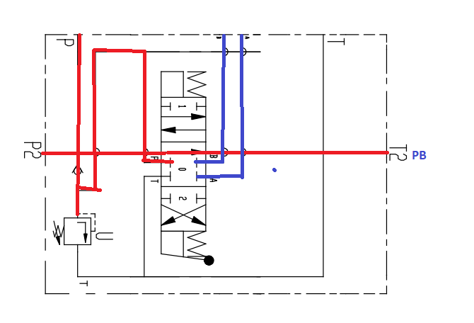

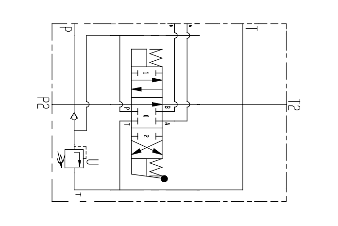

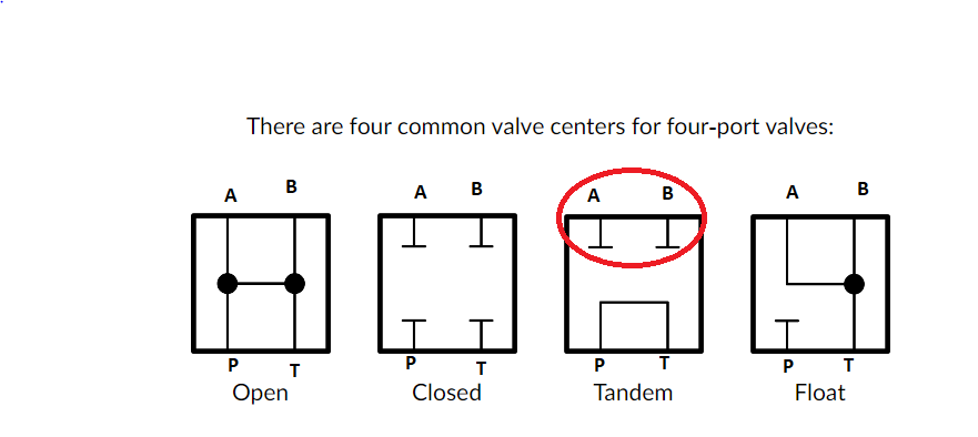

This shows the actual valve diagram you should see when ordering a valve....and explains the difference between open center and tandem center valves. Intro to Directional Control Valves.
A and B are the work ports. And when the valve is centered (not being used), if you want the cylinders to stay where they are, you need A and B ports blocked off....IE: tandem center. A true open center opens them ports to tank and the cylinders are not held by the valve.
IF you look at the diagram/manual for the valve you sent me in a PM, It does show it being tandem center and power beyond capable. The diagram for the single spool valve is on the first page. and further down the page they show the PB adapter you need to get as well. It will thread into one of the tank ports.
So on the diagram.....Which I know is hard to follow if you dont understand hydraulic schematics.....shows pressure coming in and going straight out the T2 port which is PB. ANd the A and B ports are blocked off in neutral which is what you want. When the valve shifts either direction....PB flow is cut off.....and P goes to either work port A or B.....and the work port that pressure is not going to is free to return to tank through T port and NOT the T port which would be PB if the plug is installed
So looking at that diagram.....This is what it looks like
And in neutral.....Red is pressure passing through to PB. Notice the A and B ports are blocked so the oil in the cylinders cannot excape
When shifted (you have to visualize square 1 or 2 shifting into place of cube 0)....the flow would look like:
Notice how work port A is now receiving pressure to move the cylinder, while port B is open to return the oil discharged from the cylinder back to tank, and PB flow is cut off.

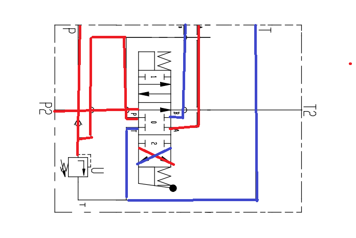

So when looking for a valve.....first and foremost you want one that is PB adaptable.

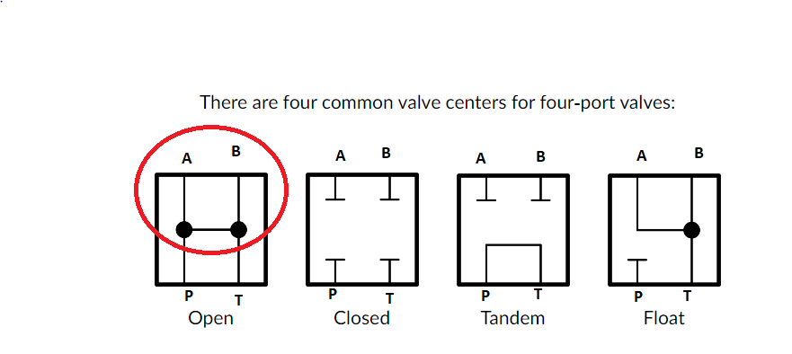

Second is you want to see that A and B port is isolated when in neutral like this:
And NOT one that is open to allow A and B to return to tank like this, which I suspect you may have.
The true open center valves are commonly used for hydraulic motors. Dont want to muddy the waters of your understanding of what you need, but when a valve is opened and a hydraulic motor is spinning.....if you had a tandem center valve....as soon as you let the valve return to neutral, you block off the flow of oil at the work ports A and B. This means that whatever the motor was spinning....has to stop IMMEDIATLY. Some things just cant do that.....think about the inertia of a rotary cutter on the front of a skidloader for example. The inertia of the cutter still trying to spin could cause a huge pressure spike and blow hoses. So true open center which is sometimes called "motor spools" allow it to spin down slowly. Thats not the only way to make that happen, and not the only use for a true open center valve....but just one example to help you inderstand.
I honestly dont know what logsplitter valves are. Whether they are tandem or open center doesnt really matter because they arent designed to hold a load like a loader.....and being a horizontal cylinder.....gravity isnt making it move on its own when in neutral.
Id still like to see a diagram or know just what valve you purchased initially to appease my curiosity. But at the end of the day.....get a PB capable tandem center valve (even if they dont use the term "tandem" just look at the diagram). ANd plumb it as I mentioned and you should be all set

really good explanation thank a million ...
that's the one I previously ordered,
/ why this is not working ?? #17
Of course they don't give a hydraulic diagram of the valve. So I can only speculate at this time that either it's not tandem center, or the pressure kickout is causing you issues....or just the sheer back pressure on the tank port.
Water under the bridge now.....cause it ain't gonna work without PB.
But I think you're on the right track now👍

#18
it’s working now … thank again

New valve, Tandem center, and power beyond? (y) (y)
