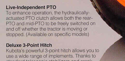

   / Why use clutch with GST? #36
GaryE…
I think I have found the answer… but not to the coffee question.
I got to digging around in my Kubota books and found a 2001 Kubota booklet on the Grand L series that covers L3010/L3410/L3710/L4310/L4610… and on the fourth page just past half way down, It mentions that the “Live-Independent PTO” is only available on specific models… evidently the L3710, although in the grand L series, and a GST, dose not have Live Independent PTO…. See the attached scan of that part of this booklet. KennyV.
   / Why use clutch with GST? #37
KennyV said:
GaryE…
KennyV,
Good find! That would explain the difference. Never even crossed my mind this might have been an option!
Now the real problem, who buys? :confused:
Gary
   / Why use clutch with GST? #38
KennyV,
Mine is a Grand L3130 and it has an independent PTO. The foot clutch has nothing to do with the PTO on mine so it's not just a 3710 or specific model. I think all the Grand L's have them. At least the newer ones in the last few years...A little Note in the manual.*****
Tractor will not start if PTO lever is in the "ON" position.***When the clutch pedal is depressed the PTO disengages { on the HST MODEL]
When the clutch pedal is depressed on a [GST, DT, Model] the PTO engages.......Hope this helps a little further.........
