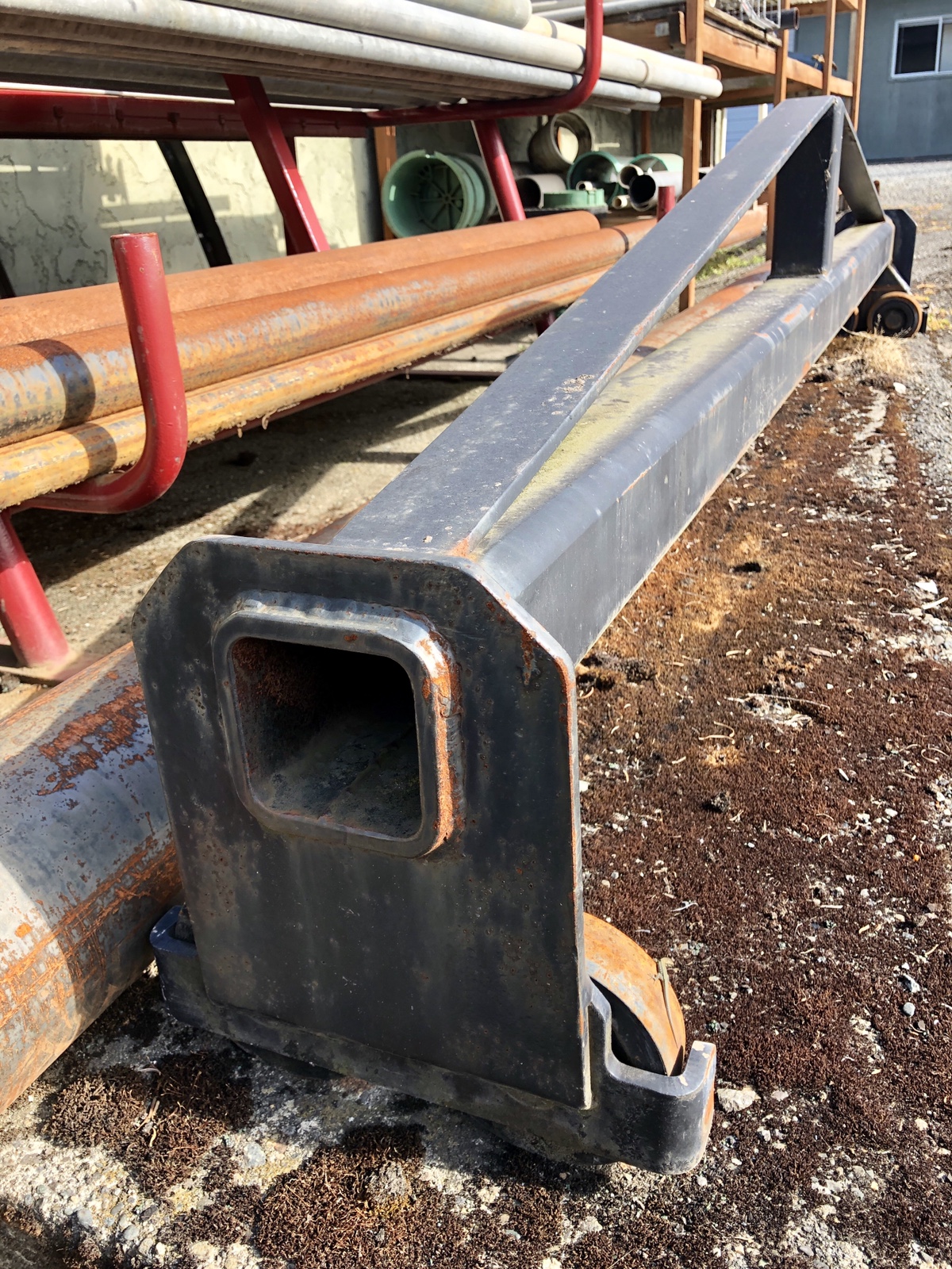

Here’s a pic of a portion of my rolling deck mount system for piggyback forklifts like on the back of Home Depot trucks.
Instead of hanging off the end of the trailer the 5500 pound forklift lift lifted itself up to deck height with this system and then drove ONTO the deck for transport. Try sitting on the forklift suspended 8 feet above the ground relying on two forks inserted into this contraption and tell me your azz doesn’t pucker.
All welds done with AC buzzbox because that was the only welder I had back then.

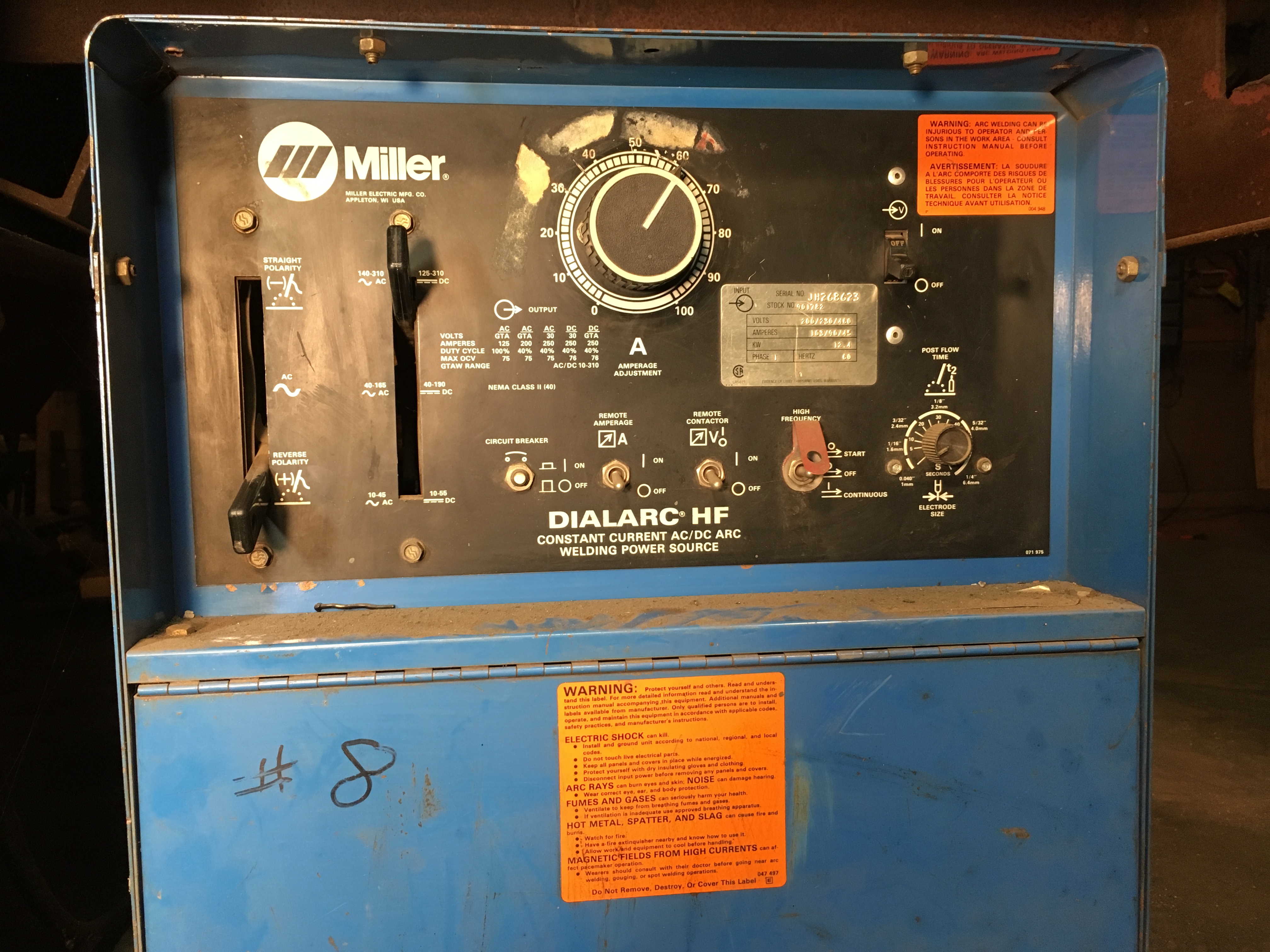

I have 30 year old Miller Dialarc stick and 7 year mig Miller-Matic 211, I find if I'm doing a lot of welding that I have to use 5/32 7014 stick to keep up with and or go faster then .030 70s6 mig wire. Mig is great for tacking and welding thin metal, stick is better for dirty rusty steel and 250-300 DC amps is a must for carbon arc gouging AKA welding rod eraser.........
