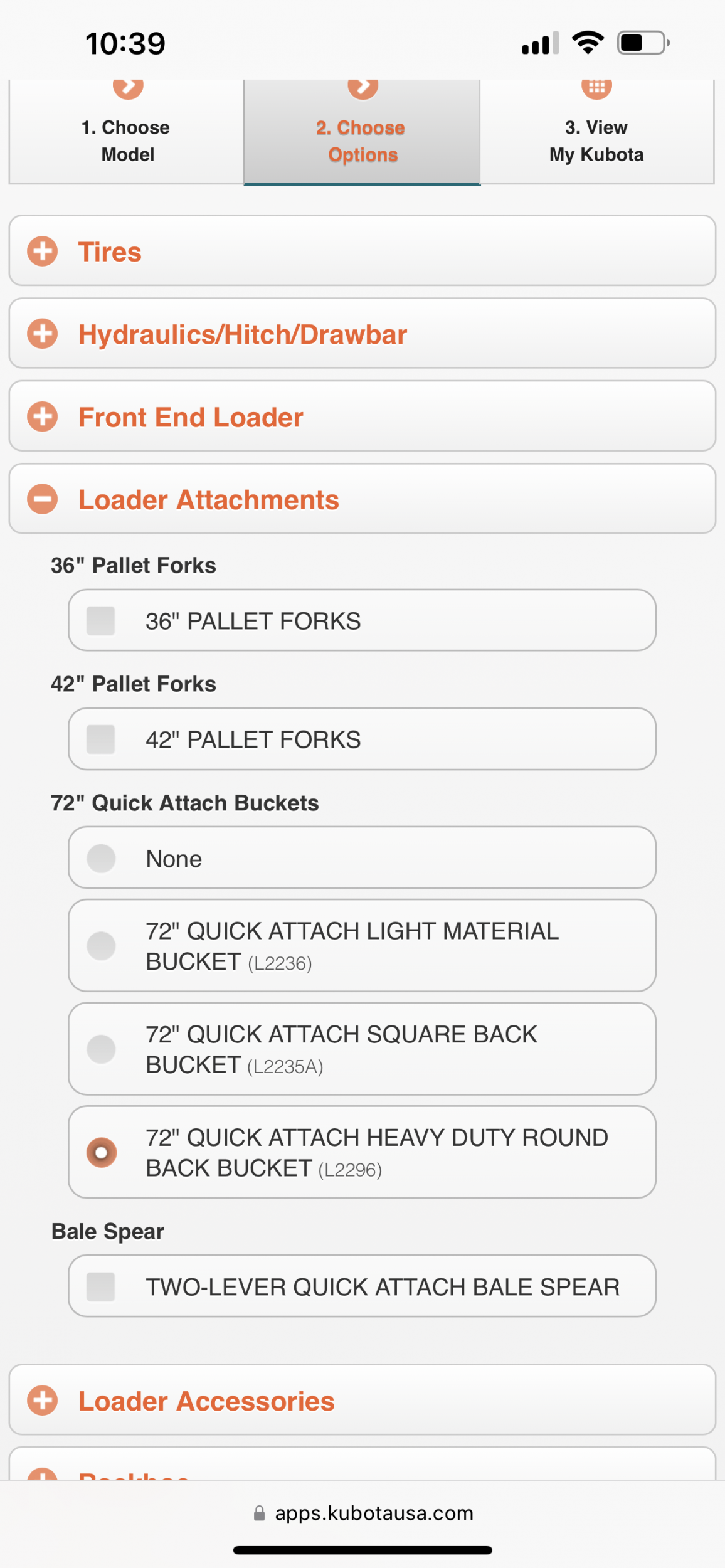

I disagree, I have one of the wicked tooth bars on my original LS bucket and it has made it incredibly strong and rigid, no sign of bowing, but it didn't really bow much before the toothbar. But now it digs much easier and effectively.
I also think it's worth a shot to try to straighten it as described, It had no problem "cold forming" out of shape to begin with.
And what makes you think every brand of tractor builders offers different loader buckets? Maybe on bigger Utility and Row crop tractors but I haven't seen them on CUT and SCUT lines unless it's a not advertised thing you have to ask for.
   / WICKED Toothbar will Transform Your Bucket #135
If you go to the Kubota website and do the builder, you will see an option for a heavy duty bucket.
