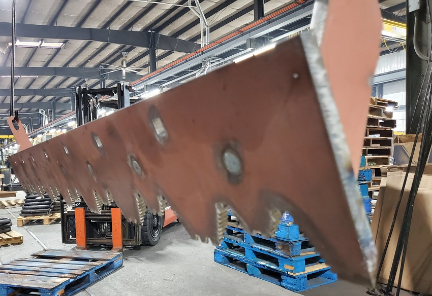

First, lets look at how the Wicked Toothbar is created, because I'm betting more goes into this thing than many realize.
It starts out as a flat sheet of Hardox 450 Steel, and our favorite laser to slice through it is the Bystronic fiber laser.
I'll follow up with more visuals. If you have transformed your bucket with Wickedness, we look forward to hearing from you!!

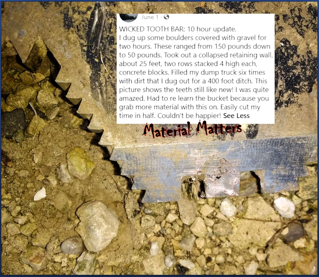

I concur the wicked tooth bar is strong, I've dug up rocks, and small boulders, backdrag using the teeth on gravel with the weight of the tractor on it, seems indestructible. Very happy with my purchase.

Here's what Wicked toothbar looks like, fresh from the laser..

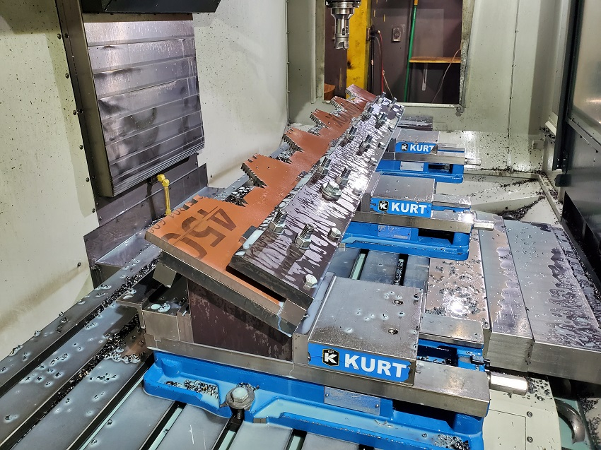

Next stop is inside one of our Haas mills, where she'll get the awesome, aggressive bevel..
Stay tuned!
Travis

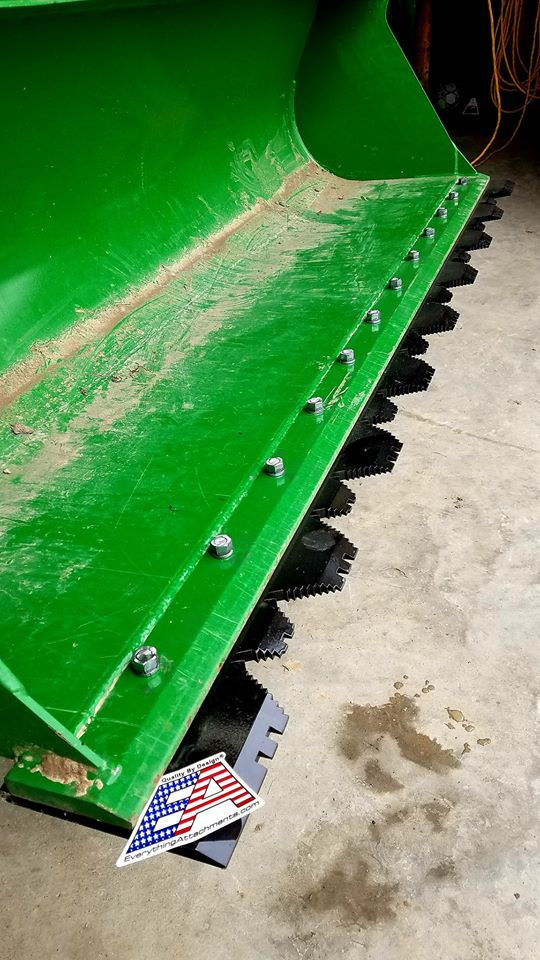

For tractors like my Kubota B26 which has a factory extra bolt in cutting edge, is a wicked toothbar available with predrilled plow bolt holes?
   / WICKED Toothbar will Transform Your Bucket

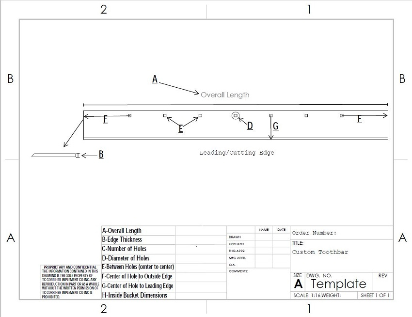

Yes, we can make it to match your factory holes, similar to this Deere..
It has carriage bolt holes. We are capable of making plow bolt holes, but for the WTB, it wouldn't be worth the cost and effort involved.
We'd need this custom drawing filled out, and price would be the same as shown on our website.
EA Attachment prices will increase the first of next week by 6%, so you could go ahead and order online if you want to beat the increase. It ships to your home via FedEx Ground and we've been around 4-6 weeks behind on toothbars here lately.
Travis

Thank you for detailing an answer. That looks real good. Custom different mounting options is advantageous. Not sure if a carriage bolt is best fastener for a cutting edge. I’m no expert just a user of plows, points and grader blades.

We've sold quite a few that have utilized the factory holes, and guys have really loved them, but if it were me, especially with a smaller tractor/bucket, I'd probably just install with the two side bolts. It is much easier to measure for and remove...as if you'd ever wanna take it off!!

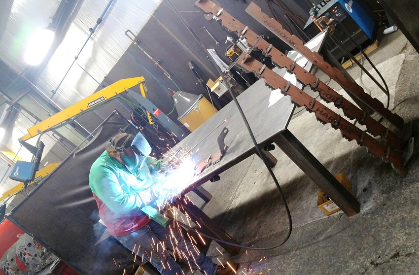

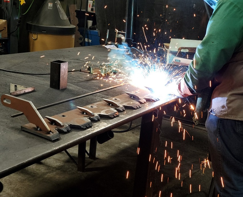

I hope everyone had a very Happy New Year. After a Wicked Crazy Monday here at EA, I'm now able to get back over here and share the next step in the Wicked Toothbar manufacturing process..
After each bar is milled, which creates one heck of a Wicked aggressive angle for digging and ripping, especially with those staggered, laser cut serrations, then it's time to weld the triangle keepers and side ears on..
The master of this art is Ryan.
-Travis

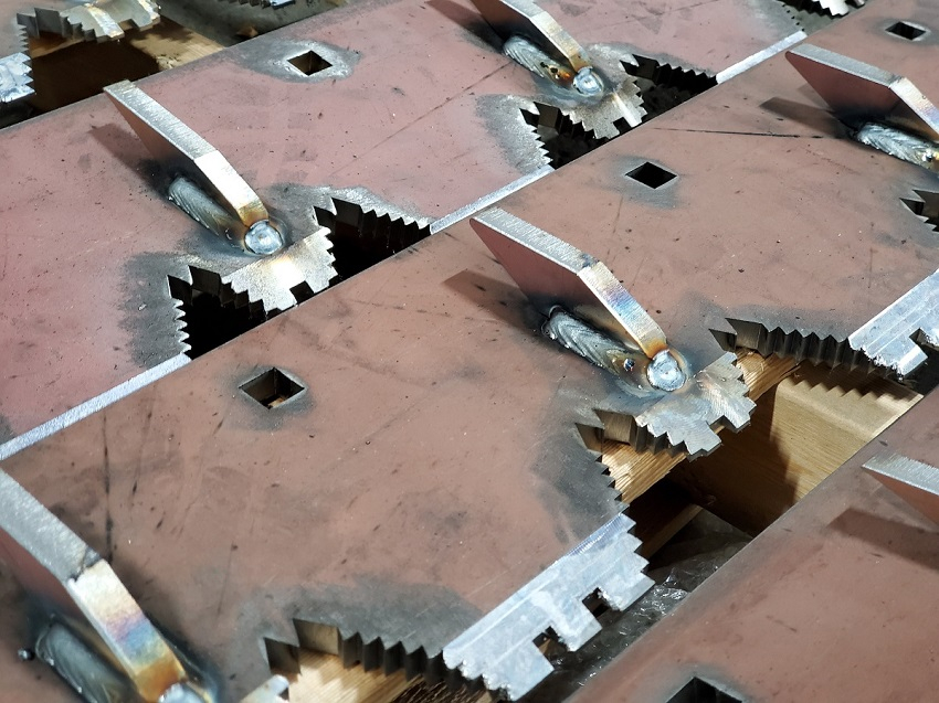

Fully welded, nekkid Wickedness sure is a thing of beauty!
This pic shows that the triangle wedge keepers are also plug welded underneath, which results in an incredibly secure attachment. The keepers fit perfectly into the laser cut holes, just like legos! #QualityByDesign
