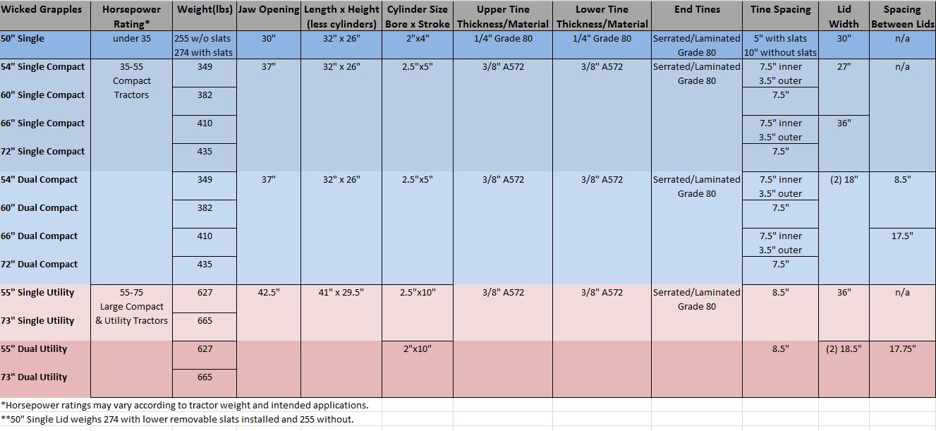

Here is a chart. Let me know what can be done differently. It needs to be simple and easily understandable.
If you have a recommendation for the rating column, it needs to be simple so it can be incorporated into the chart.
There are 3 basic categories:
50" single lid
54-72" compact
55/73" utility
SIMPLE is the key word.
We aim to please.
Thanks
Travis

That's helpful. I recognize the Excel spreadsheet look and it might be better to increase font size or play with the formatting so there is not quite as much white space.
The names are easier to understand. Maybe the 50 needs its own name (light duty compact??) but the simple light duty, compact and utility designations are much easier to grasp.
I'm glad to see the "mega compact" term removed but the horsepower breakpoint is still in there. Just doesn't make sense to me. I like the idea of calling the 627lb grapple utility instead of compact though.

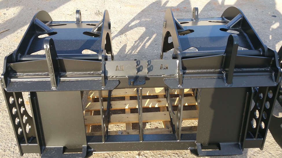

Can you explain the weight difference between the 54 single compact and the 55 single utility. Yes, it is clear the utility is 9 inches longer (I presume bottom tines are longer) and I suppose the upper jaw must also be longer and wider but there must be some other significant amount of steel somewhere that isn't obvious. Both use the same 3/8"A572 steel and have the same number of tines. Does the utility grapple use a different size square tube??? Are the outside bottom tines doubled up on the 55?? The 55 weighs close to double what the 54 does. I can't make the math work on how that happens.
   / WICKED Utility Grapple!!!
#95

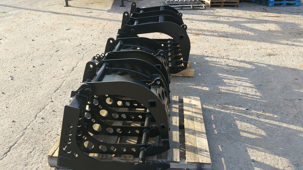

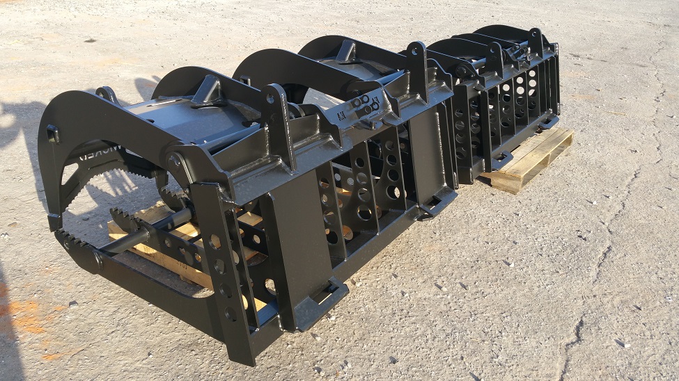

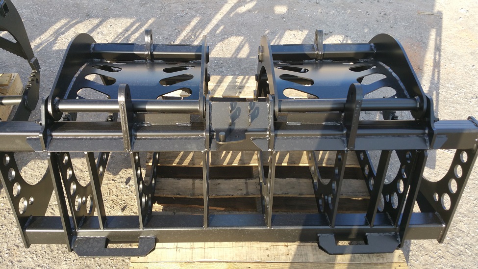

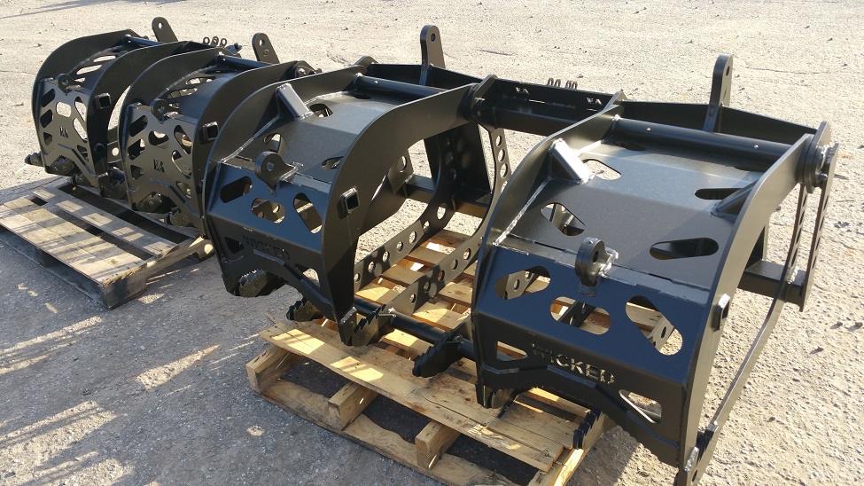

Can you explain the weight difference between the 54 single compact and the 55 single utility. Yes, it is clear the utility is 9 inches longer (I presume bottom tines are longer) and I suppose the upper jaw must also be longer and wider but there must be some other significant amount of steel somewhere that isn't obvious. Does the utility grapple use a different size square tube??? Are the outside bottom tines doubled up on the 55?? The 55 weighs close to double what the 54 does. I can't make the math work on how that happens.
We didn't stray far from our original Wicked Design. It's proven, people love it and it just plain works. Tubing and tine thickness is the same on the lower body.
The plate steel, strong gusseting and framework on the lids is heavier. Cylinder mounts, hinges and hitch are all areas that are beefed up.
The main difference that translates into weight is that it is physically much larger.
Pictures are worth 1,000 words! We love pictures, right?
54" Wicked Compact beside a 55" Wicked Utility
The difference is pretty obvious when they're side by side.
Travis

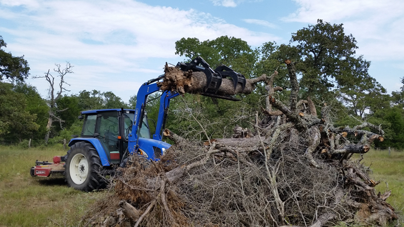

Why did we beef it up? For crazy people like this. Please don't try it!!

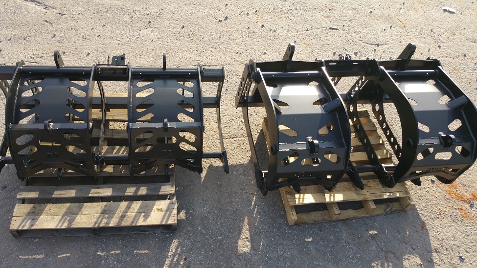

Where's the little one? We need to see a family photo of baby bear along with momma and papa bear.
#98
That would also be informative. I can make it happen when daylight returns!
