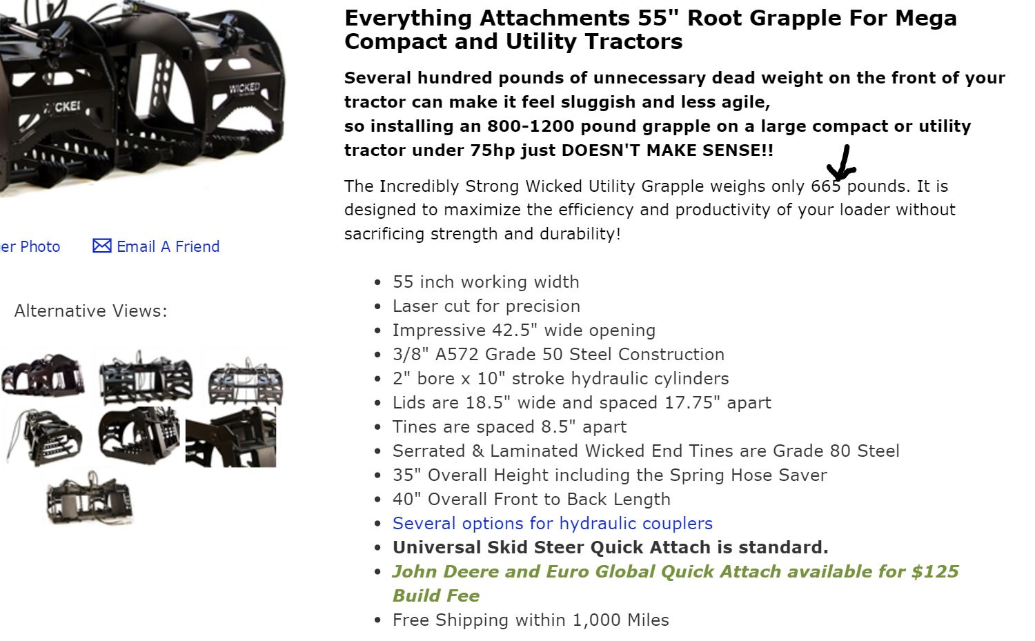

I too am confused as to where the extra 300 lbs shows up on the
Wicked Single Lid Root Grapple for Large Compact and Utility Tractors 55"
versus the
ETA-SLRG-54 54" Single Lid Wicked Root Grapple
. I see a wider lid and a larger opening but the weight almost doubles.
And going by the ad copy:
Several hundred pounds of unnecessary dead weight on the front of your tractor can make it feel sluggish and less agile,
so installing a HEAVY GRAPPLE just DOESN'T MAKE SENSE!!
it seems to steer me towards the ETA-SLRG-54 for my 47HP M4700 which weighs about 4,000 lbs WITHOUT loader and is presently 77.5" wide.

And going by the ad copy: it seems to steer me towards the ETA-SLRG-54 for my 47HP M4700 which weighs about 4,000 lbs WITHOUT loader and is presently 77.5" wide.
That is exactly what I would get and IMO is the exact grapple that virtually anyone with a 35-65 HP size CUT would be happy with.
Tractor width is really not very important as the grapple behaves like the bow of a ship and pushes brush away from the wheels. You only drive as far into brush as it takes to fill the grapple so it's not necessary to create a full width path.
There are many advantages to a narrow grapple and only a few for a wide grapple unless you are primarily engaged in construction.

The 54" is IDEAL for compact tractors from around 35HP up to 55HP. It weighs 349 pounds. 37" opening. We have one that's even lighter for less than 35HP.
The 55" is IDEAL for HEAVIER utility tractors up to 75HP that have more pushing ability, twisting power, ramming power, down pressure, lift capacity etc.. It weighs 627 pounds. 42.5" opening. Ideal. We offer this one in a narrow 55". Why? Because IslandTractor and others boast about a narrow grapple ALL THE TIME and I pretty much agree with him. I hear people all the time bragging about their heavy duty grapple that is 850 pounds. NOT IDEAL!!
That would most likely be my pick, unless certain circumstances told me otherwise.
The M series is technically a utility tractor. The L5240 is technically a compact tractor. They're fairly similar. That is why there's not a simple, cut and dry method of grapple recommendation.
Many times, we need to talk through things to make a solid, educated recommendation.
