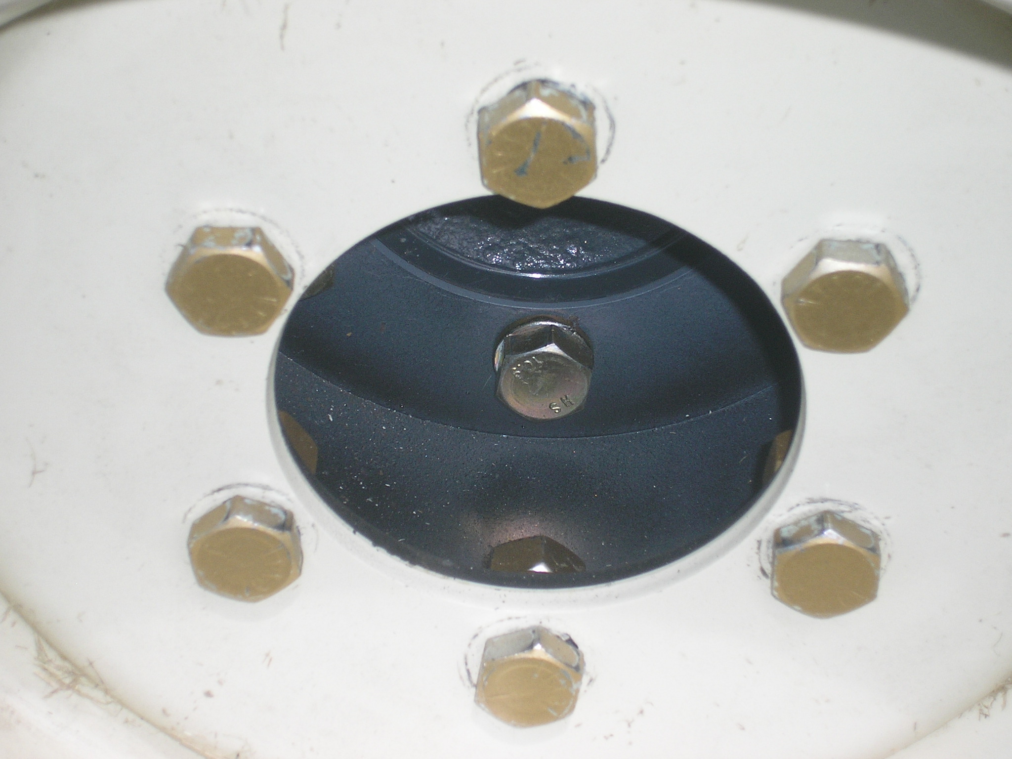

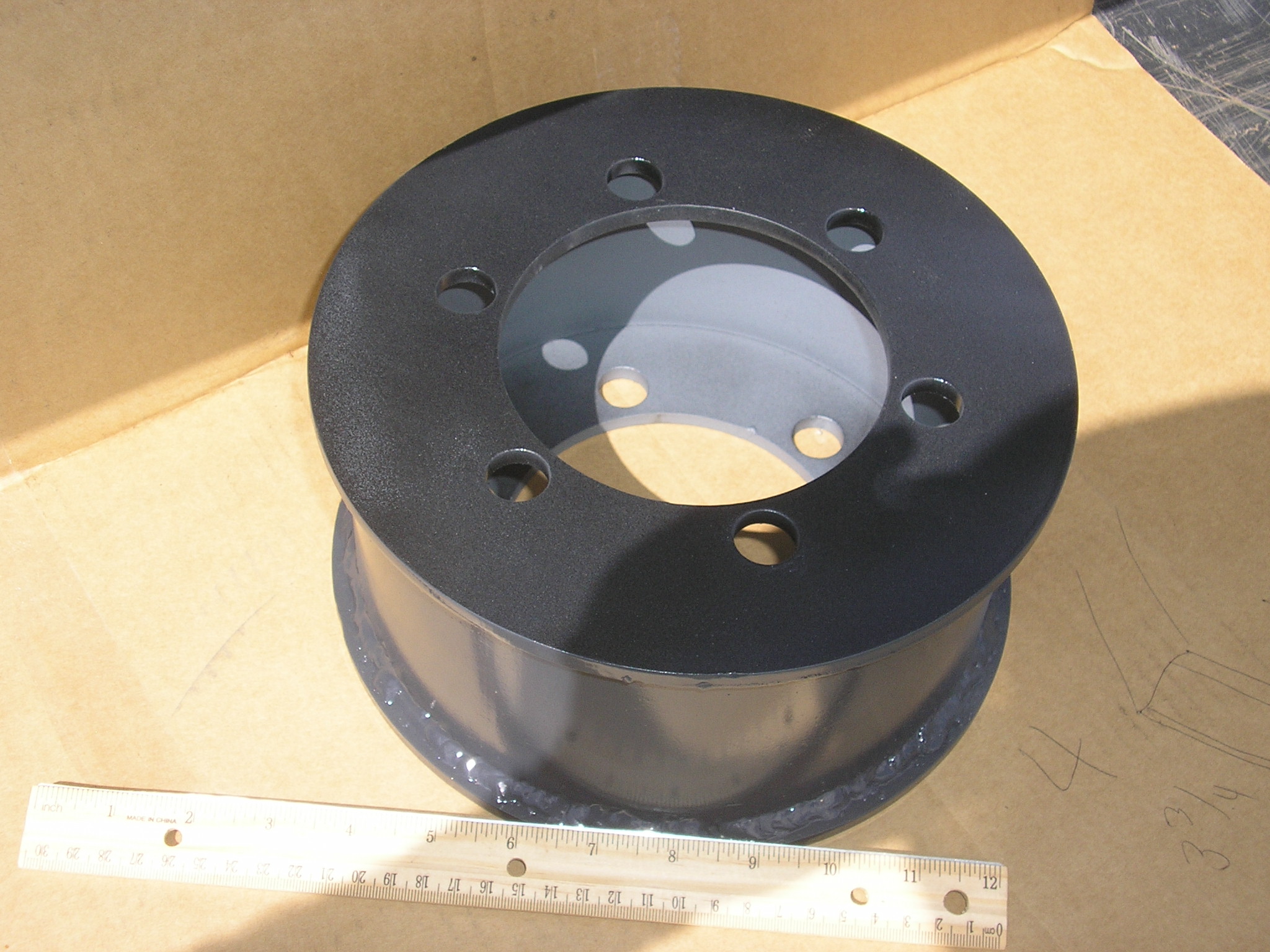

You have one more option and that is to fabricate a spacer that mounts between the wheel hub and the wheel. I am having trouble posting pictures all of a sudden and will send this answer and come back and see if I can add a picture.
Point here is that I wanted to widen the rears on my 2400. I bought a piece of シ" (thickness determined by size/weight of tractor) cold rolled steel plate and a piece of Schedule 40 8" (diameter selected to conveniently encircle my bolt pattern on this tractor) steel pipe. I cut the pipe to 4" determined by my desired widening dimensions.
I made a pattern of the interface....just took a wheel off the tractor and use it as a template and took that and the steel to a local machine shop. They did a super neat job of making the flanges. Came home and welded it up and done deal. Total cost right at a hundred bucks.....half as much as what I could have bought online at half the width.
Let's see if I can add the pics.

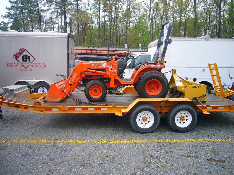

My equipment trailer bought with my B7610:
has the fenders 78" ww to ww.
My M4700, as purchased was 81" wide, so after swapping around it barely squeezed through the fenders
but it fit and balanced.

Must have gotten spoofed. Trying again:
