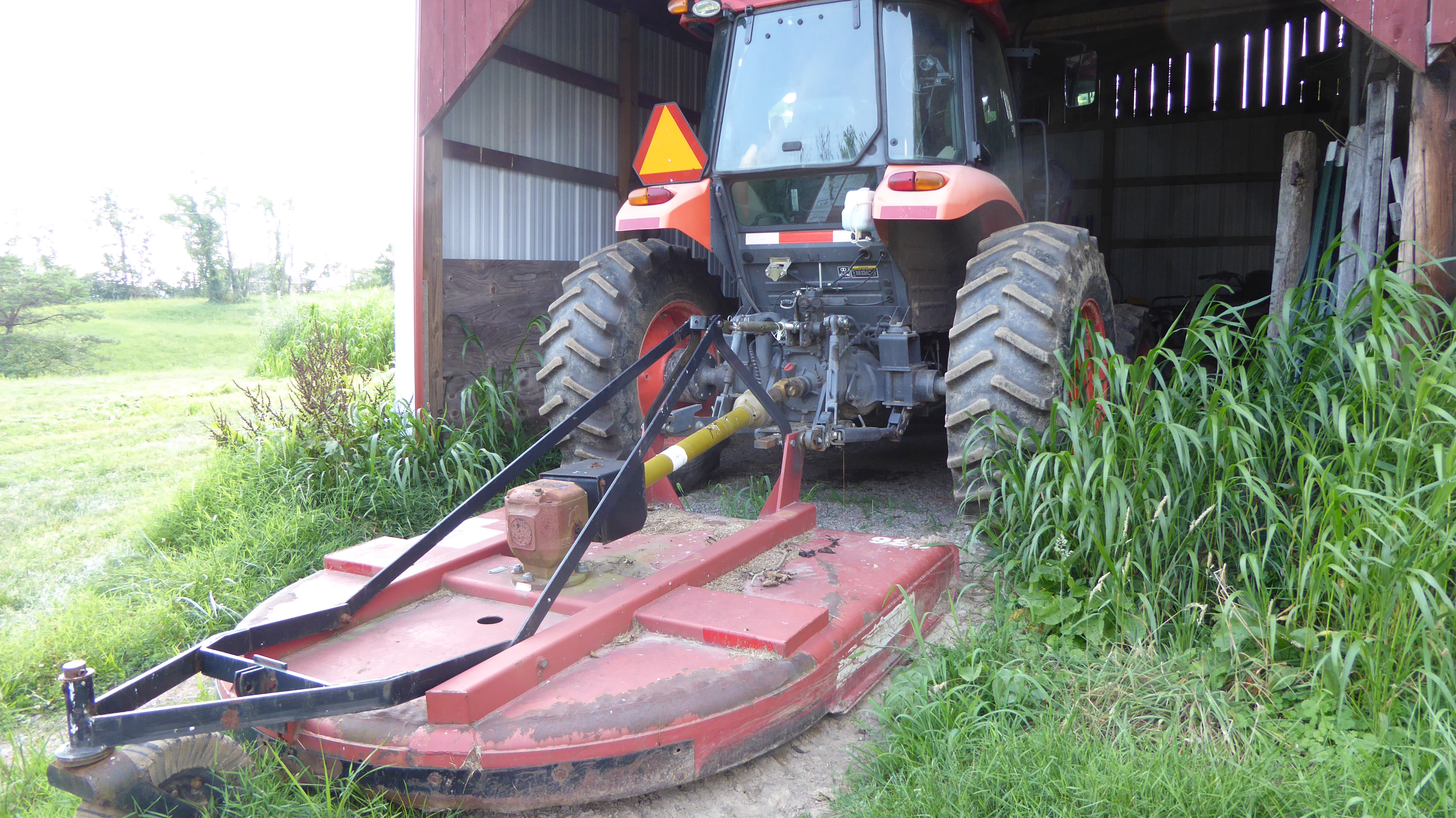

What I said was that Kubota rear wheels cannot be set out as far, typically in a given size of machine, as other brands. That is true based on measurements I have taken and looking at dozens of them on the lots. Not hard to verify and pretty universally known. If they are wide enough for you and very stable for your work, great. Conditions vary. P1020885.JPG

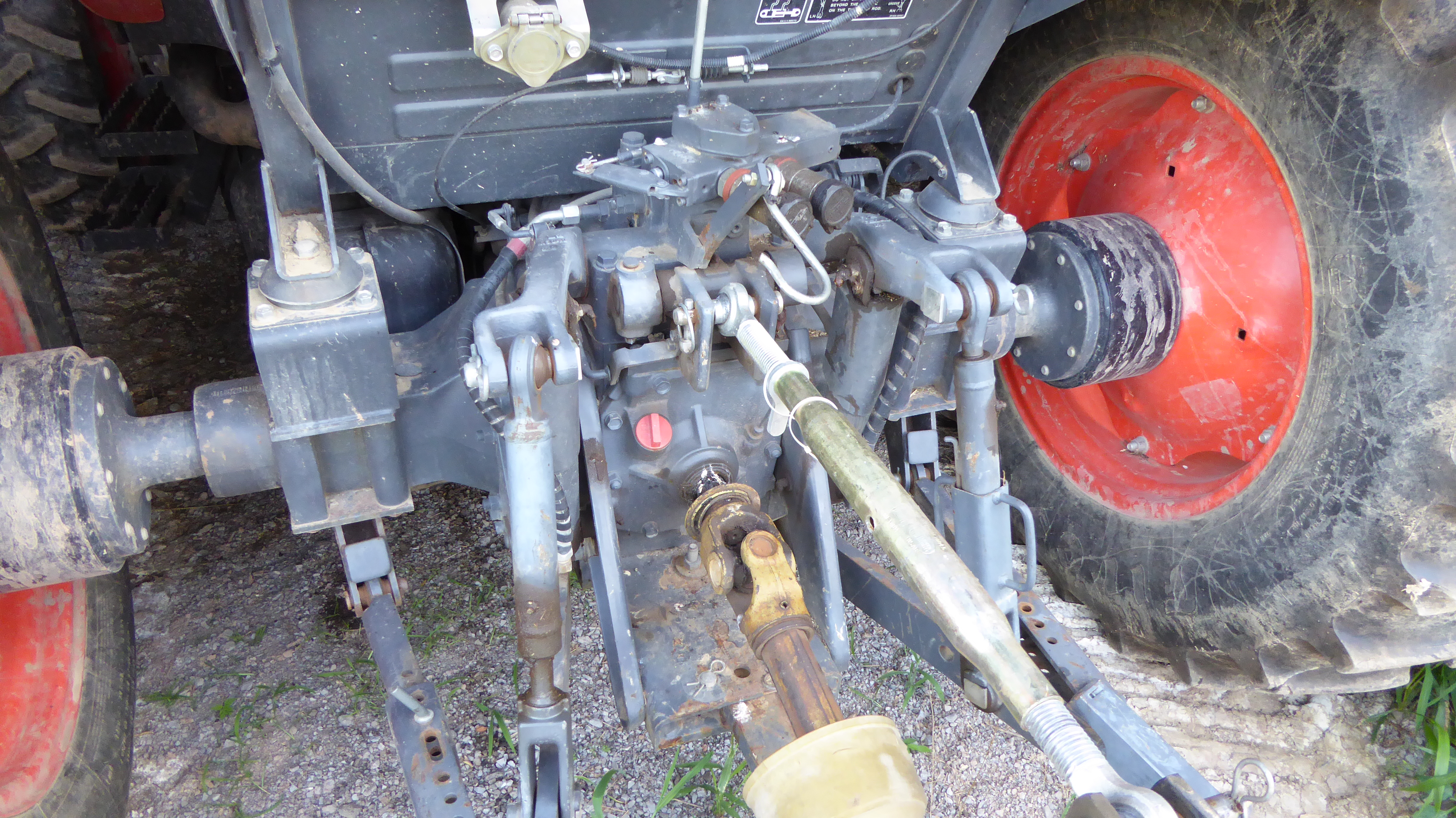

These two photos are of an M6040 cab model used primarily for bushhogging, mowing and moving round bales, etc. The spacers are 6" each side. With spacers as the 2nd photo shows, the tire tracks are a little wider than the 6ft hog. The owner wants to use a wider hog but whether they really will, who knows.

What I said was that Kubota rear wheels cannot be set out as far, typically in a given size of machine, as other brands. That is true based on measurements I have taken and looking at dozens of them on the lots. Not hard to verify and pretty universally known. If they are wide enough for you and very stable for your work, great. Conditions vary.View attachment 494909

Just stopped by the dealer on Saturday. My rear wheels are set in the middle position. If you look at some of the pictures posted, that puts the center of the tread about even with the fender edges. I think that will do well for my moderate terrain. I'll post pictures when I take delivery.
JWR - I appreciate the pics with the 6" spacers. This gives me some reference as I kept my 6' Bush Hog and wanted to see how it would cover my tracks. The current wheel setting isn't out that far so I should have better coverage when using the 6'. No problems with the 12' Batwing of course.:thumbsup:
