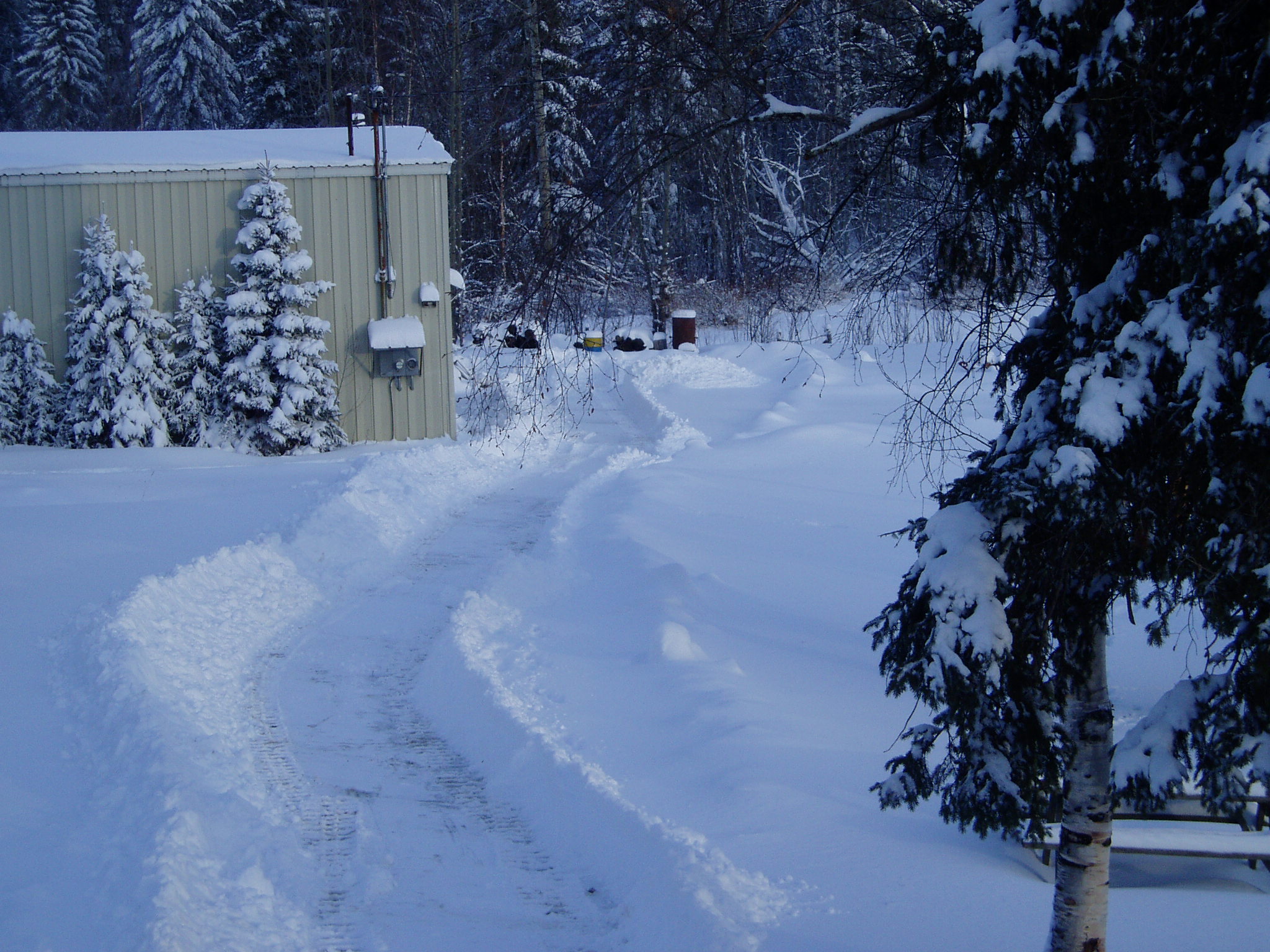

My drive is around 350 yds long from gate to the house, plus about 75 yds from the house to the workshop and then 100 yds from the workshop back to the drive way. A fair bit of snow removal. It also has some bends and a bit of a small hill - I have in the past, slide off into the snow banks at the side (forgot to engage 4x4 ).
Have attached a couple of pictures. The one of the snowblower is a shot of the previous owner using it. The second picture is of the workshop from the driveway - fork in the road up to the house.
So, yes, we can get some good dumpings of snow too. I previously used the old JD450 I have, to clear the snow but all I did was make snow banks and the driveway got noticeably narrower :-( I like being able to throw the snow away from the drive where it is not in the way.

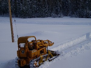

What machine made the path through the snow in the second pic?
A JD450 is a crawler. Was it that machine?

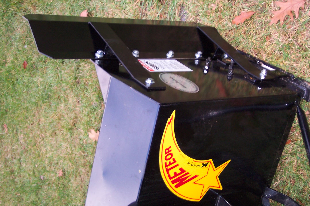

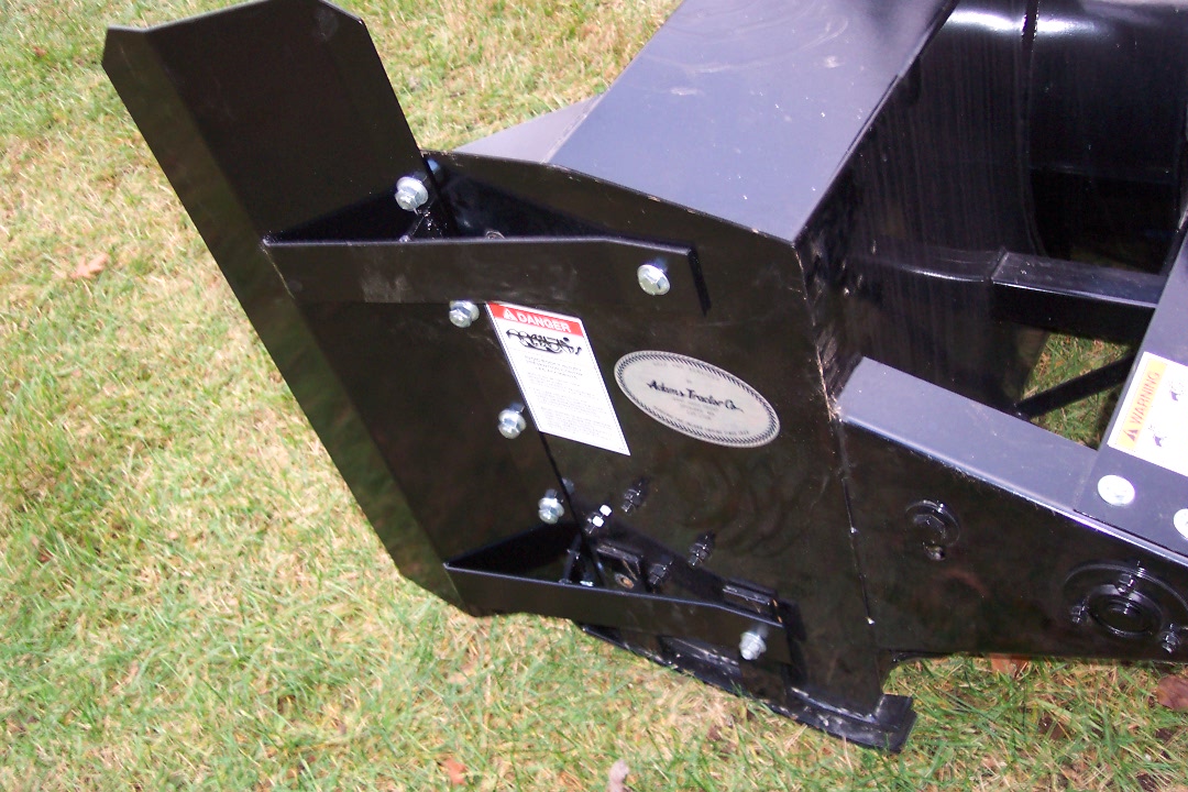

My wings have worked out well so far. I added about 5.5 inches overall. A lot of snow is funelled into the auger, overwhelming it in deep and/or heavy snow so I have to go VERY slow at times. Mine are made very stout with bracing. Some have suggested making them bendable so as to allow the wings to fail before a more expensive part. While there may be some merit to this idea, I find that my snow blowing speed is slow enough that nothing is likely to bend or break if a wing contacts an immovable object.

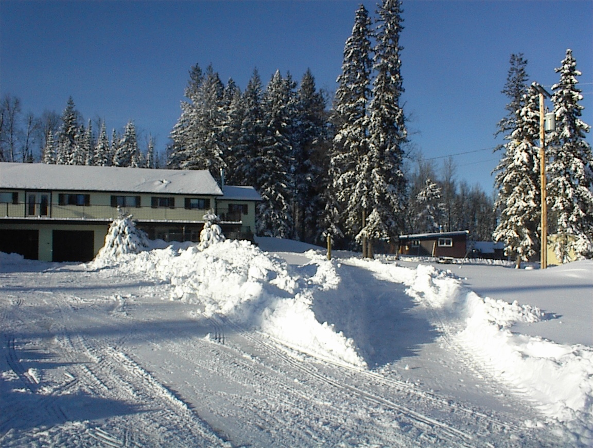

Yes, the JD450 was used to clear driveways - the bucket removed and an outside frame with a 8.5ft dozer blade fitted on the front. Worked OK but doesn't compare to an appropriately sized blower - the snow banks grow very quickly in a heavy snow winter :(:(. And yes, a heated cab would sure be nice too :D:D:D

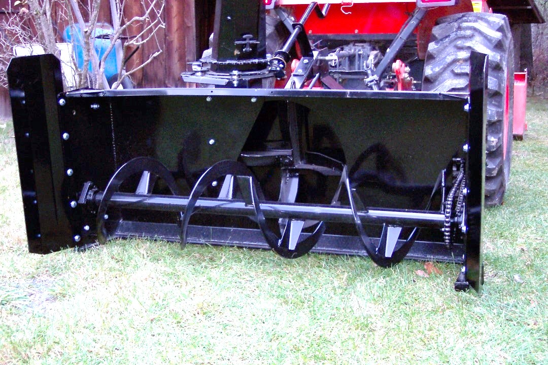

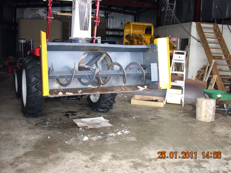

Hi Guys,
Here is w hat I ended up with. The extra width is 4" on each side. That amount makes a big difference and I now have around 2" clearance each side, on the rear wheels - no more pulling snow down.
I have only used them the one time so far - and of course I found snags and bent each wing just a little at the bottom (rocks protuding from soil and frozen solid into the ground ?). Gonna put extra skids or runners on the bottom of the snow blowers - which should help.
Thanks
Jim

Thanks for posting final results, with pic. Looking good. Always good to know final results.I think you made a wise choice to change original plan of 6" per side to 4" per side.
