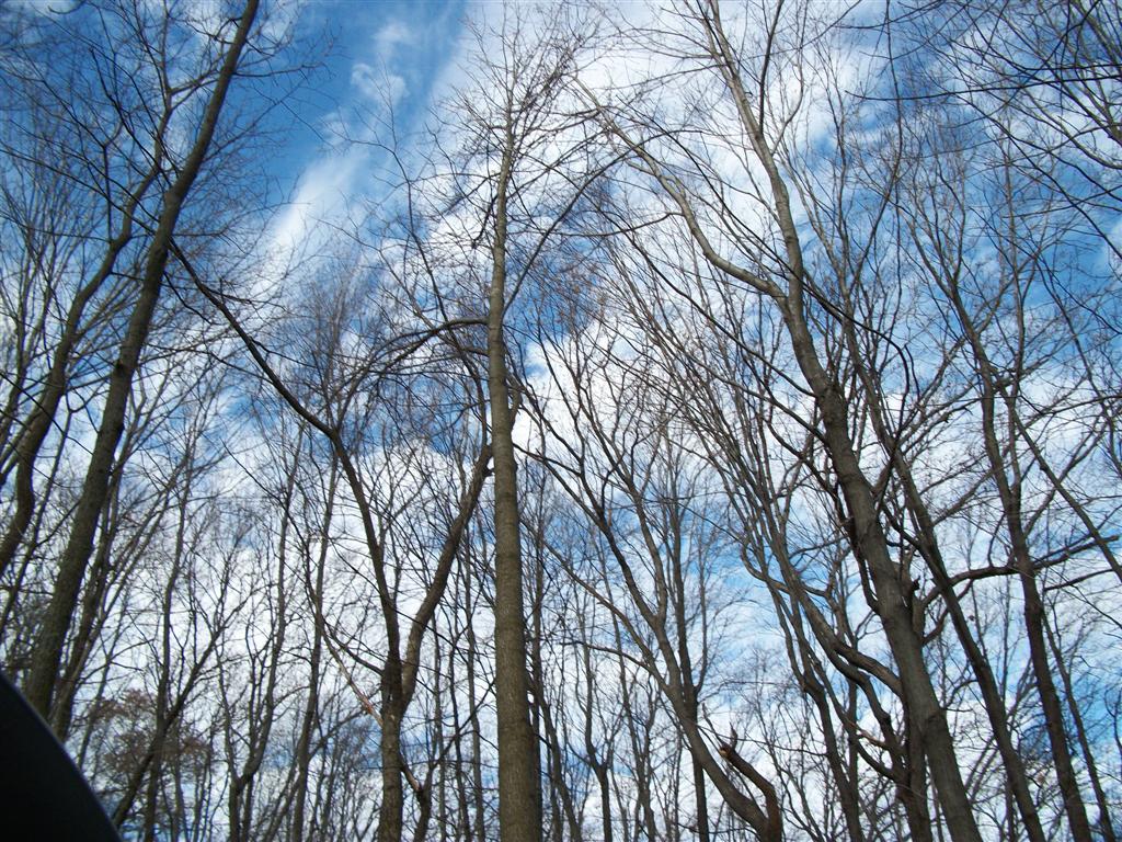

I had this beauty right over where I mow. We called some pros to take it down. I saw no good coming with my attempting to get it down. Sometimes ya gotta know when to fold em. Sorry about the sideways photo. Just don't look at it while others are watching you.

Nice call there Harpoon that would have been a fun one to cut. Lot's of rot to make things a little dicey.

Both of the trees shown in the sideways photo need to come down. The one to the left is rotten and near dead. Hopefully the pros you hired took care of it for you.
I'd have likely tossed a rope or cable over the broken top and pulled it down with the tractor or truck. If that didn't work (wouldn't break loose at the break), then I'd have figured it was solid enough to be notched at the stump, and made a backcut to create the hinge, and pulled it over.

The other one is geriatric :laughing:
