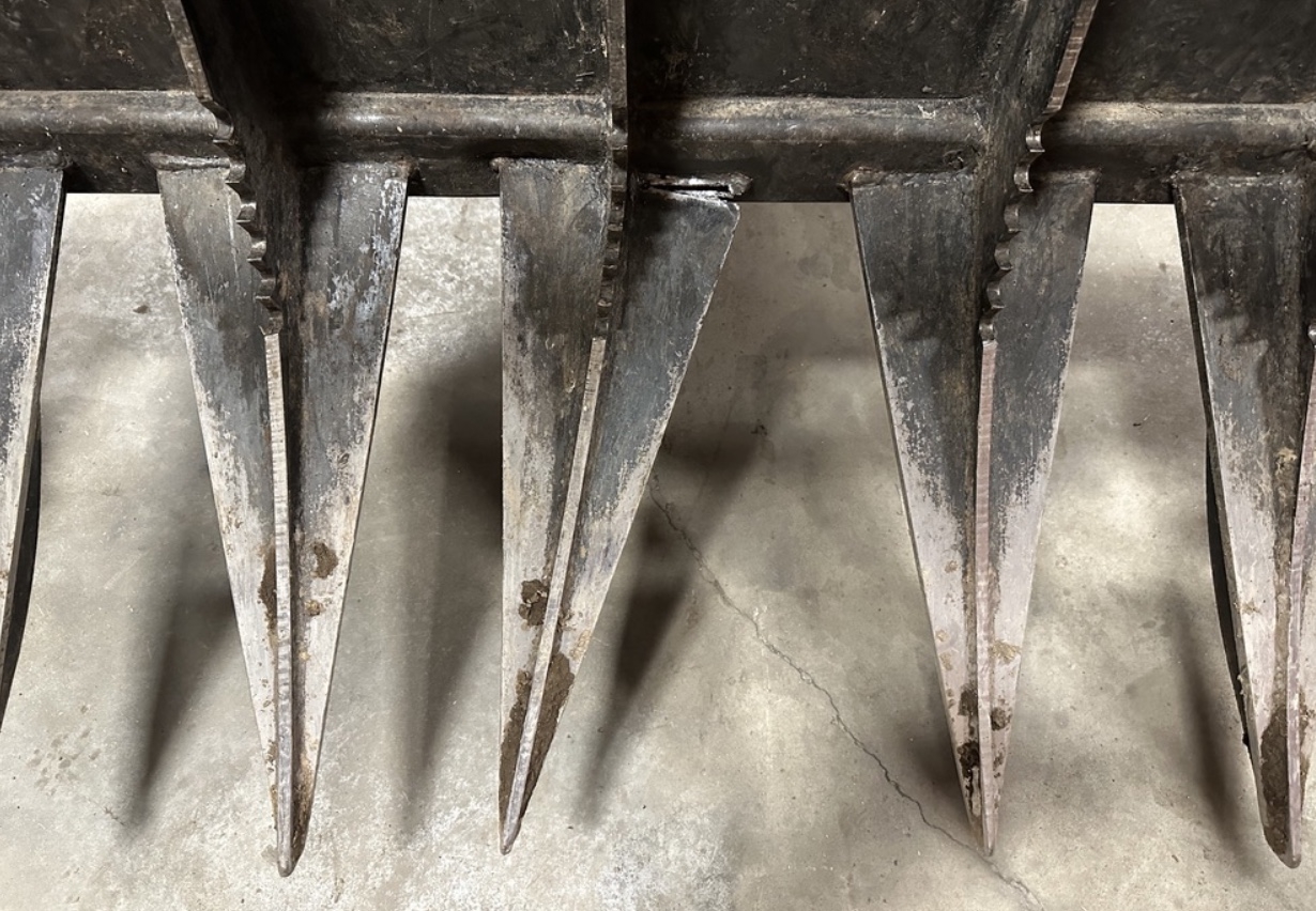

Somethin’s up. I just found another one at a local equipment jockey. It has serrated teeth on the radius and some labeling.
This guy at JM is usually about as affordable as it gets, but he’s $400 more than the other one.

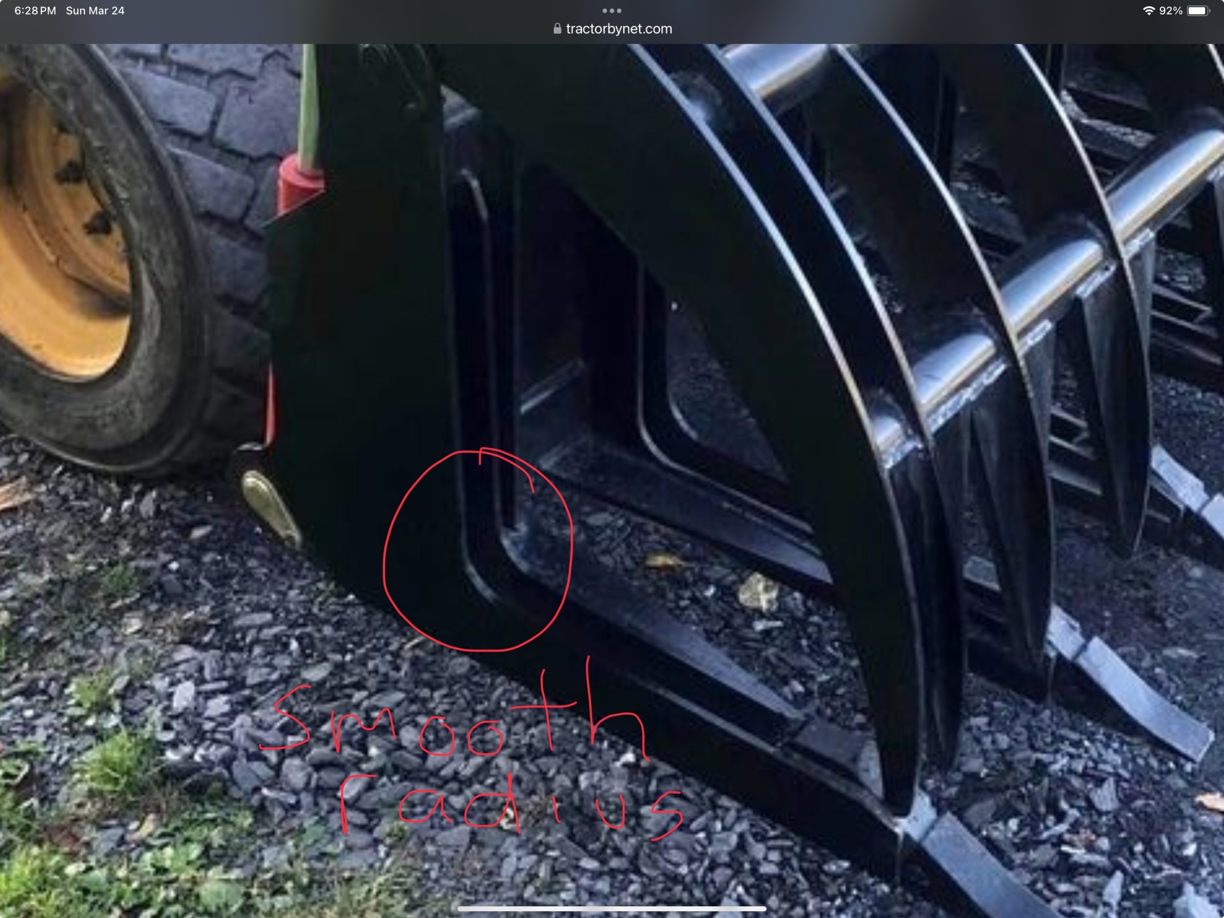

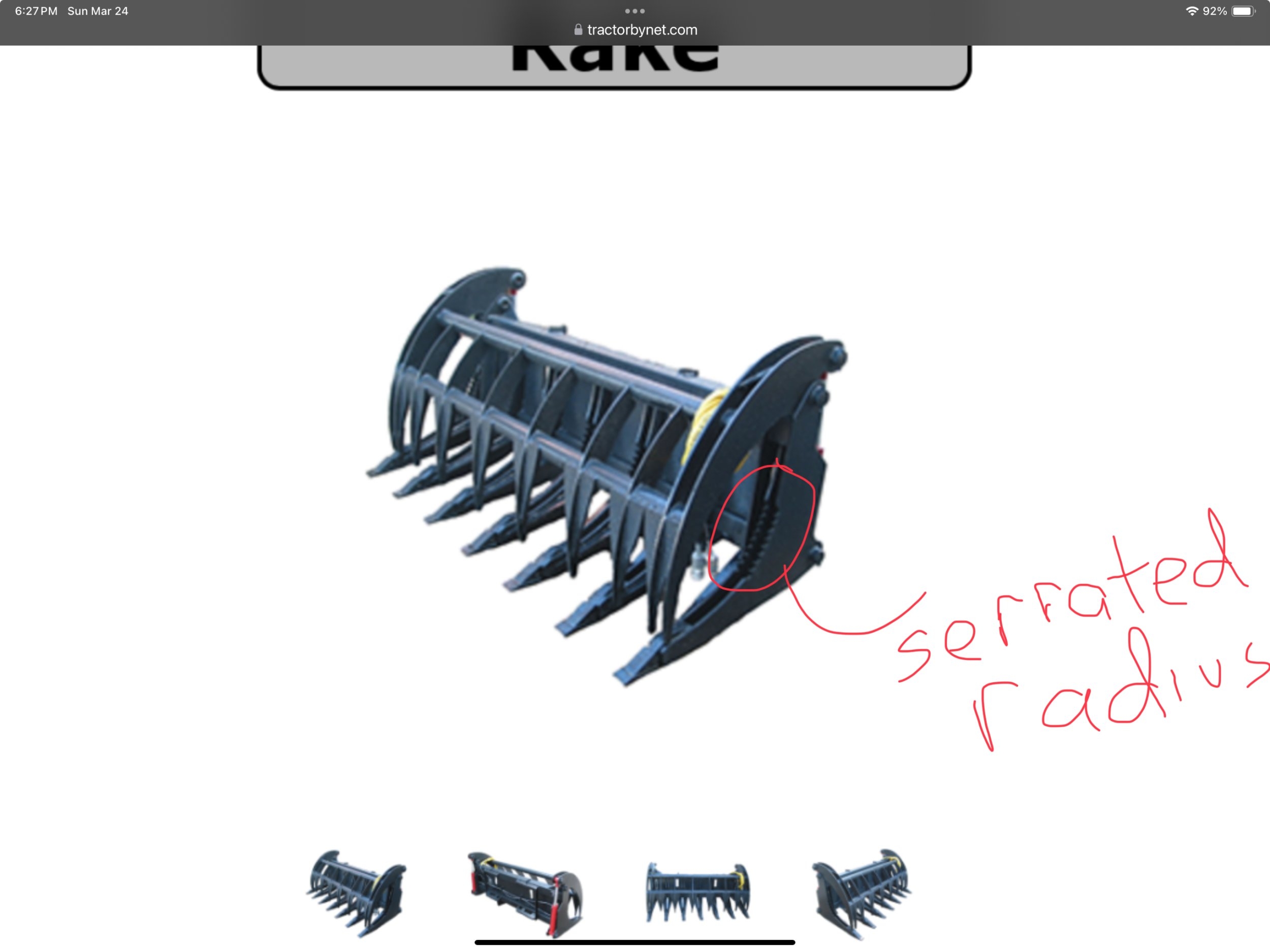

Wait, I see differences. Look at the curvature of the lower tines.
The radius is smooth on the one for sale. The radius on the Wildkat brochure shows serrated radius.
I see some other subtle differences, too.
Maybe these are irrelevant or just slight design changes???
Probably just design changes. I noticed that the 'Granite Grapple' for sale here by a vendor is a little different than the one I have.

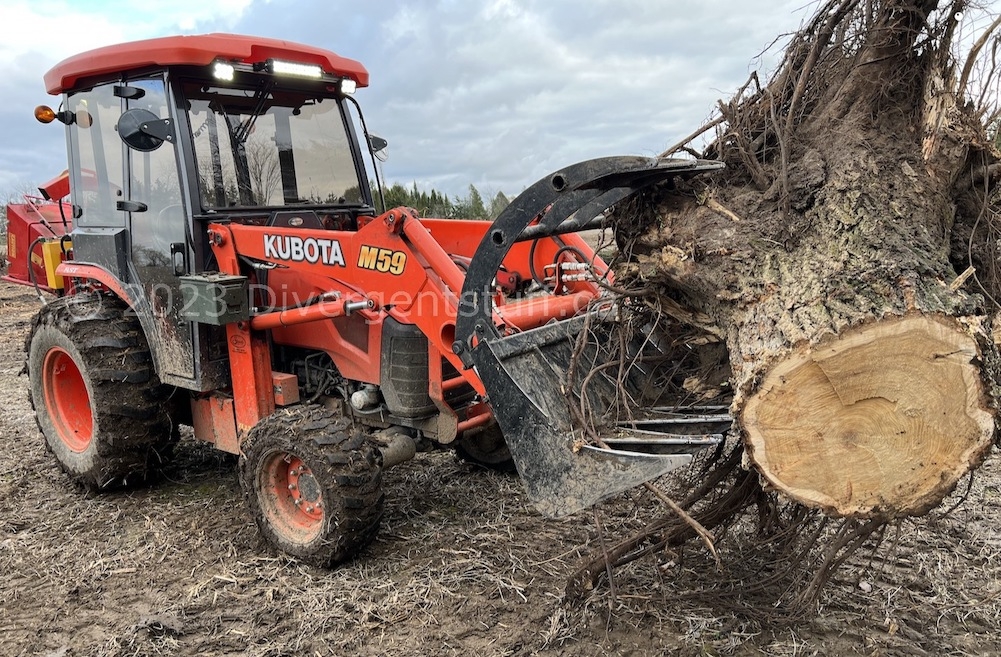

Here's what heavy 1/2" mild steel tines, poorly welded to 1/4" mild steel tube with unsatisfactory gussets looks like. I know it's 1/4" thick tubing because the grapple lid cylinder mounts tore a hole in the tube. I also discovered that the thick black paint concealed a 1/8" thick galvanized fence post tube holding the top lid together. That lid broke in half due to fatigue trying to grapple root balls.
This is why I ended up fabbing my own grapple using AR400 and twin lids. I found the single lid was ok for handling telephone pole like logs but struggled with everything else.
I also prefer the long bottom grapples now - if you have the loader capacity you can grab and carry more brush/logs etc. Could never hold more than a few logs on the old grapple.
